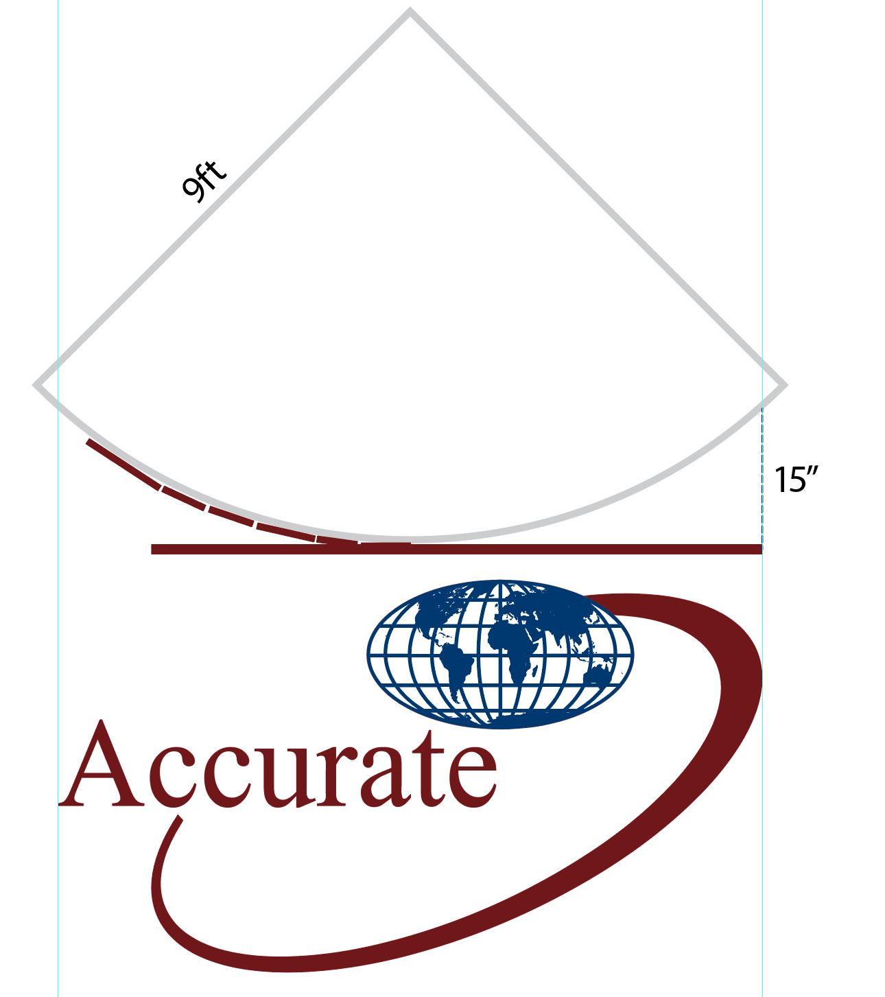

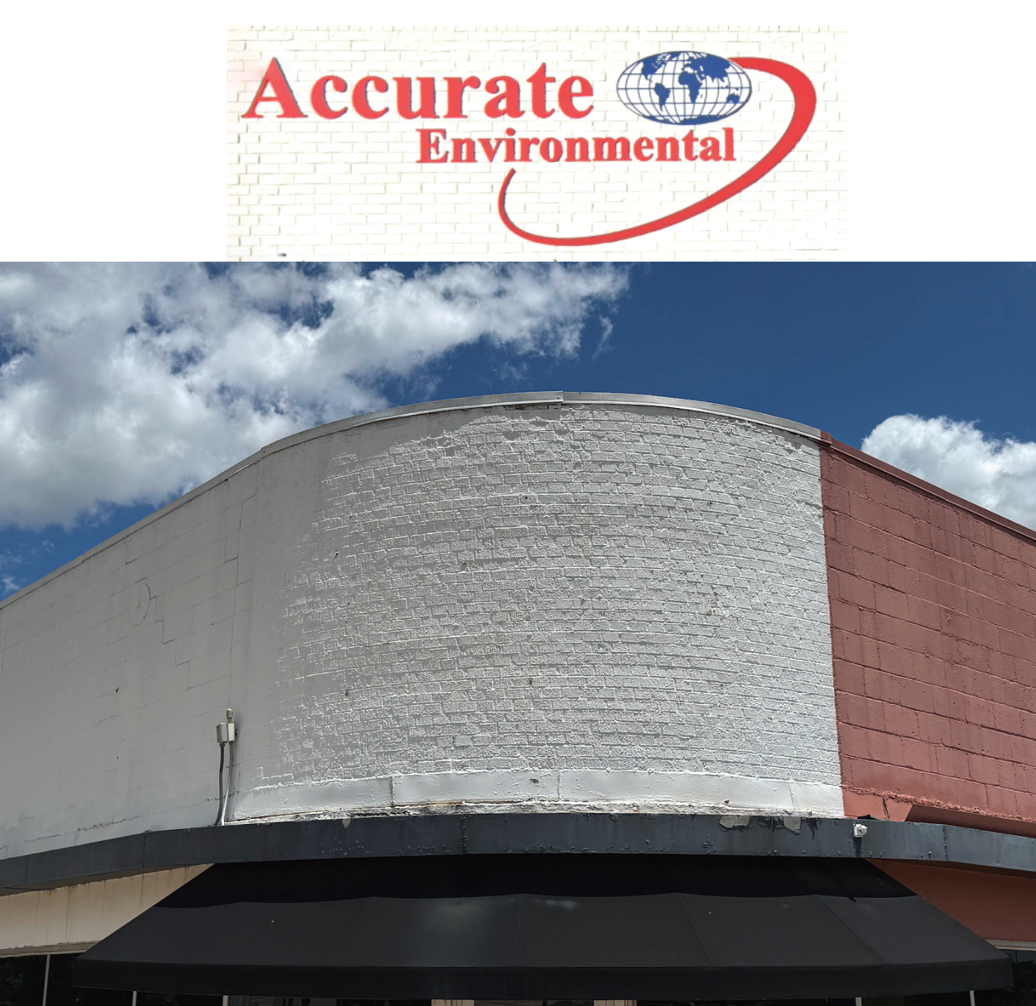

I've got a customer requesting dimensional letters / logo (metal), to be installed on this curved brick wall. Who out there can fabricate this sort of thing? Seems like it would be pretty difficult to fabricate -- probably in the neighborhood of .75 - 1" thick (similar appearance as their other locations, but this is the only location with a curved wall). The width of that logo will probably be about 6ft wide.
(I'm waiting for them to take down the awning so I can use that frame to measure the radius)
It also occurs to me that using a regular stud mount might not work so well on a curved wall since the studs need to be parallel to each other, not perpendicular to the surfaces. Hmm...

You can use letters from any manufacturer of dimensional letters. The curve doesn't make any difference. The red swoop might be the only piece that would show it. You can measure the amount of curvature over the distance it covers by going up on the roof. If it's enough that the studs on the ends wouldn't reach, then you might have to have a curved piece. In that case it might be better to make that piece as a fabricated letter rather than a router cut letter.
tulsagraphics
With a 6ft wide "flat" logo, the right edge ends up about 15" away from the building. It's such a thin swoosh to be hanging out in "open air". About 4.5" thick at the widest point, down to under 1" on the left side.
And if done this way, the letters and logo end up on different planes since the letters would be installed / spaced around the curve. Maybe not that noticeable? Not sure yet -- will have to 3D model it for a better visual.
unclebun
Yeah, that would have to be bent. The globe might have to be too if the curve of the wall is that great.
