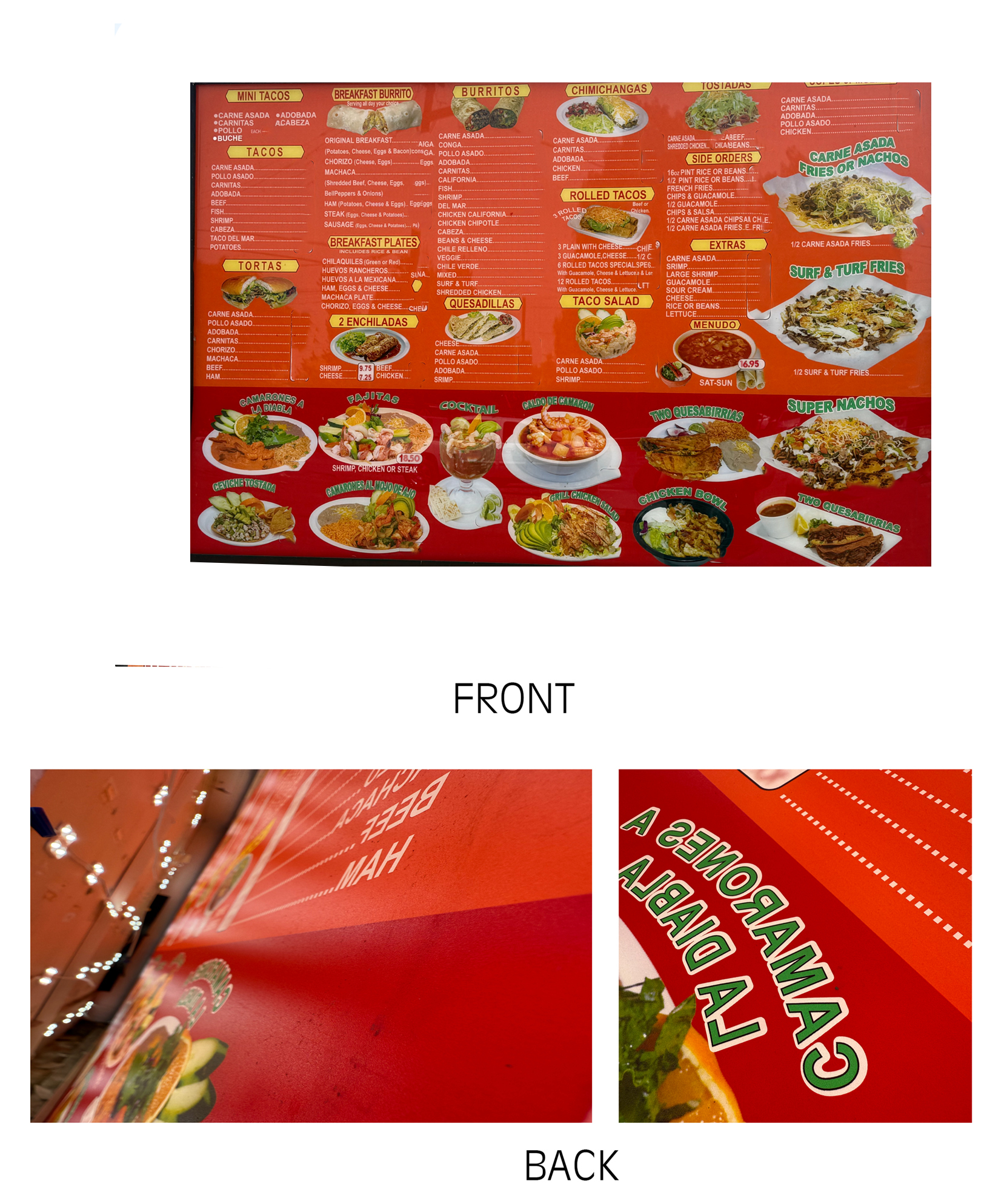

for glass doors ... THANKS ! ! !
			Impossible to cut and weedyes... but better to plot and weed white vinyl, if possible for the artwork.... the negative space will never be as optically clear as the glass (though some come very close.)
Yes print white on clear all the time. On Clear GlassApeel.Impossible to cut and weed
Have you tried 50% white? I've done CWC with the white set at 50%For backlit menu, we use a UV flatbed to print on white acrylic/polycarbonate, no white ink as that blocks light from passing through.
Works if using clear acrylic/glass/polycarbonate but found using a light diffusing white plastic to begin with tends to be more economical in time and ink.Have you tried 50% white? I've done CWC with the white set at 50%
