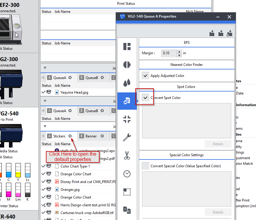

When exporting from Corel (or Illustrator) there is often a setting to convert spot colors to CMYK. If that is selected, you're no longer working in spot colors which defeats the purpose of the Roland color library. This is the first hurdle.
Then in Versaworks, on the File format tab of the Queue Default settings (this will not be available in job settings after you import the file) make sure the Convert Spot Colors is selected. These two items set correctly will allow you to print with Roland Color Library to match the color chart that you printed previously using the same settings on the same material. Charts are media and print mode specific if your very color conscious. (By the way this setting in VW will also allow you to use the Pantone look up tables which will get you close on most colors.
This very thing just bit me for about an hour when trying to get the perfCut to be recognized in Versaworks from Corel. Strange thing was that even after correcting this, it seemed that I needed to restart Versaworks to get it to finally pick up on it in the file - like there was a setting being held for whatever reason.
