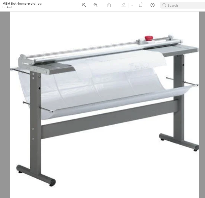

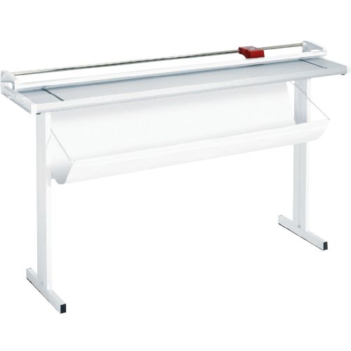

I use the MBM Triumph
AVOID Rotatrim and Foster Keen cut. RotaTrim 54" Is 54" oh you say your roll of print media is 54.25" Yeah go kick rocks buddy
when the say 54 it is 54.
Both Rota and Foster have flexible clear pressure mats with referance lines.. that aint worff a tinkers dammm.
The MBM is $1200 and is a worthwhile trimmer table for the avarage shop. Its clear rigid Line referances (3) do a respectable job
but if you are going to do a kiss cut i lacks a little, but you dang sho aint doing that on the Foster or Rota. not a chance buddy boy
A laser referance would have been nice and I have one from a guitine cutter that I will retro fit.
None of these come with locking casters. Big whoop, just go to a big box and buy some.
What sux on all of these is there are NO Media holders for roll media.
Some have a cheap flimsey option. Dont waste you mon Ey. Make One you own self
Now If you have an old POS Graphtec FC 7000-130 KEEP THE STAND AND MOUNTING BRACKETS,
A MBM Triumph retrofitted to a Graphtec FC 54" Plotter stand is GOLD ! Sccratch that,, its Pure Paladium!
You print a whole 54x50 roll of square labels with a 0.01 spacing and throw that roll onto the Graphtec
media rollers and over the top into the throat of the MBM.
My Boy a 50yd Roll of 3" x 5" Lables will trim down in less than 3 hours and 90 minutes in the gulitine cutter.
You are wrapping and Packing before Lunch.. Are you F' N kidding me????? I am a 41 year Veteran in Graphics
I double dawg dare you to try to beat my time. If you think you can, Yeagh Uh huh Suuuuure you can,,,,,,,,,,NOT!
I chit you not man MBM Triumph/Graphtec FC-130 Plotter Stand/ any cheapo Laser guide mounted/
like that guy on Youtube who cooks the Cajun Food Says,,,,,,,,, Duuuude, Thats MO NEY.
These trimmer tables are gold for shipping out your jobs... Looks like was produced at a Factory,,, Your Factory.
