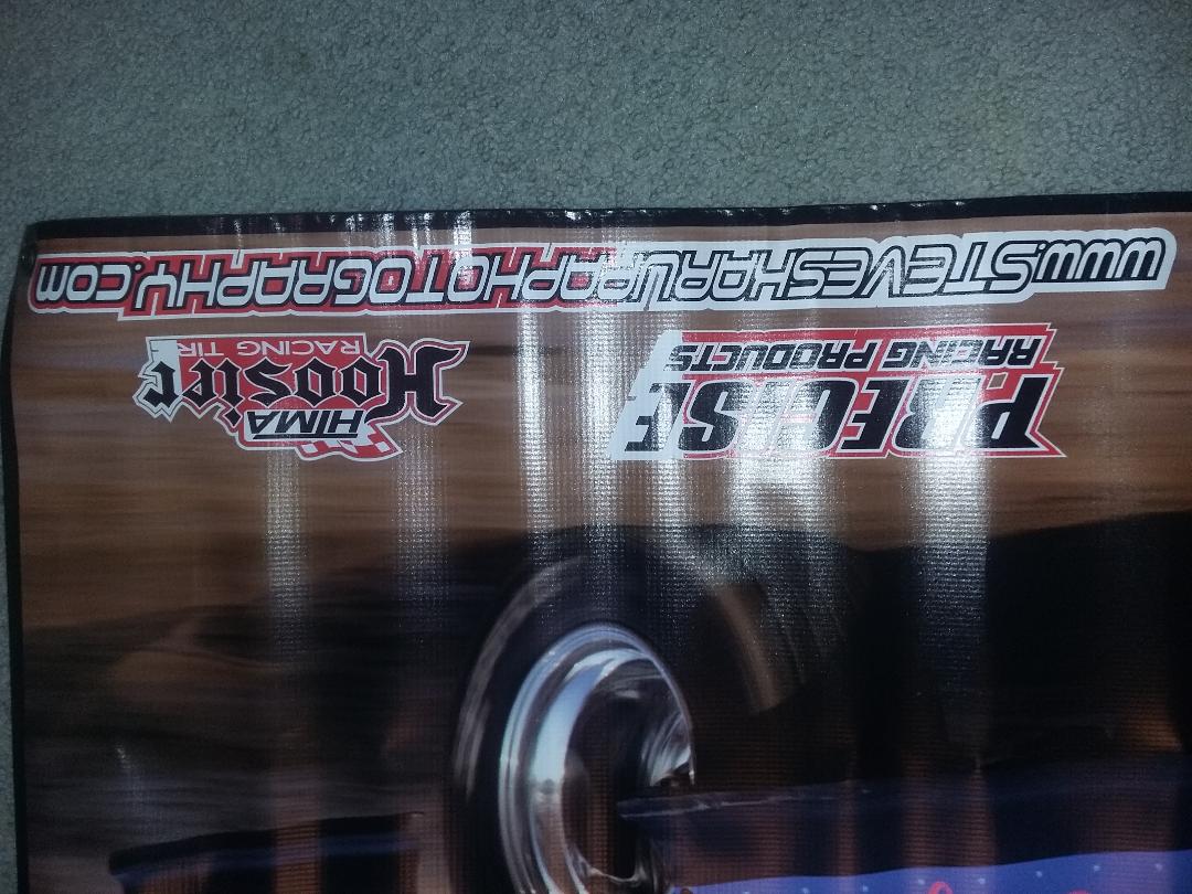

Its a jpeg back ground with vector text. I tried the pdf last time and it chopped colors in half and doesnt weird things. Atteched in the picture a lot of the red was missing. Happens all the time colors get cut off in half.
I exported at 0 compression, 3ft by 6ft @ 300 dpi. Would that print nice?
