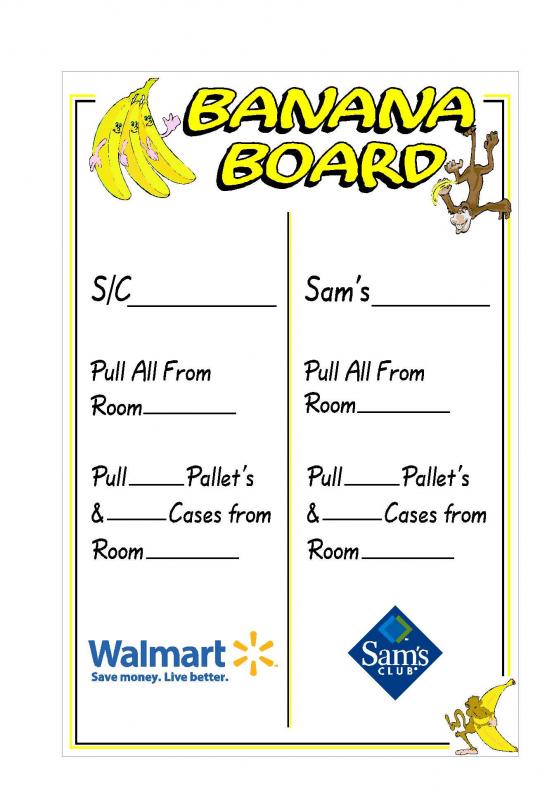

ABPGraphics
I did a banana board for my brother in law who works for distribution center - I used the dry erase laminate over the printed image - I did this about 8 months ago - I just talked with him and asked him if he had any kind of issues with the dry erase - he told me it has worked perfectly since he received it
+1 dry erase lam from fellers
