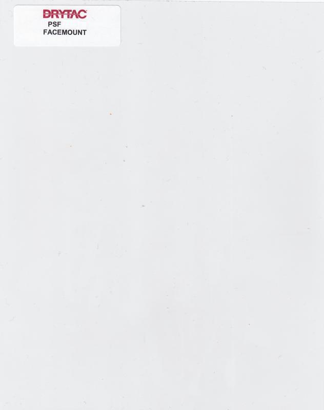

Pat White
The sample that I was sent from DRYTAC say's PSF Facemount and that's all there is.
There is no grid printed on the front.
Maybe I have the wrong material because the only thing it say's is DRYTAC PSF Facemont.
Since the material is pressure sensitive what type of laminator should I purchase?
Special Thanks Jim
chafro
I have been using it for years. Mine has never come with grid.
just use your nails!!! The liner is there. It's a very basic adhesive.
Jim Hill
Crazy that some get it with a grid and others do not.
Please see the attached photo of what I received from DRYTAC in 8 x 10 sheets.
See attachment

Jim Hill
Chafro I have a question for you.
I was wondering if maybe the reason that some people get their DRYTAC Facemont with a grid on it is because they purchase it in rolls.
Do you purchase yours in rolls or sheets?
I have been taking your advice and trying to use my finger nails to separate the different layers and I was wondering do you apply Facemount manually or with a roller laminator?
Because my nails are not very long I have been using an Exacto knife to life each layer.

chafro
I buy rolls and they have no grid.
I use a seal laminator. I face mount photograps to plexi so the prints that I mount are normally big. We do from 8"x10" all the way to 4'x8'. I would say 25" average. It's a great quality adhesive.
