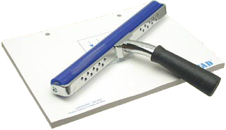

This.... roll your substrates before application, and all your prints before laminating. Can't live without it.
