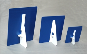

Does anyone know of a easel back like in the picture that will hold up a 18" wide by 24" tall Ultra Board or posibly a styrene sign. The largest one I have found is the 15" one shown in the picture. I will need about 30 of these and need to find something with a reasonable price.

Circleville Signs
+1 making your own. A little difficult if you don't have some type of routing capability though - the flutes in coro make cutting rounds a real challenge by hand...
I thought of making my own but I don't have a cnc router and I'm not sure it will economical enough to dead them out to be cut.
Josh-does Micheal's have something taller than 15"? These will be 24" tall so I think the 15" one in the picture are a little to short. I would like them to be around 20" tall.

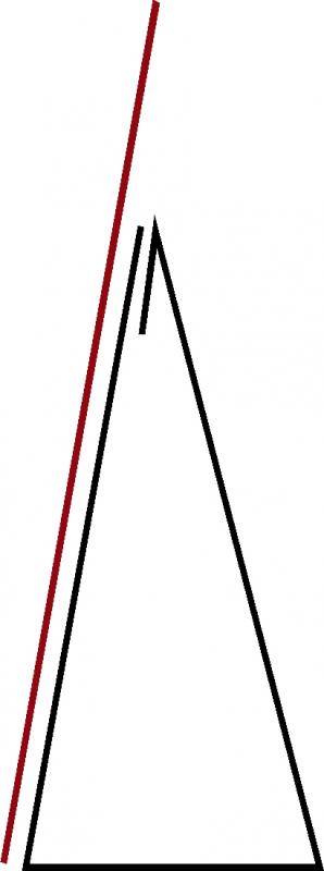

It doesn't have to be that exact design. Three straight cuts a little dbl stk tape works fine, and it's more stable

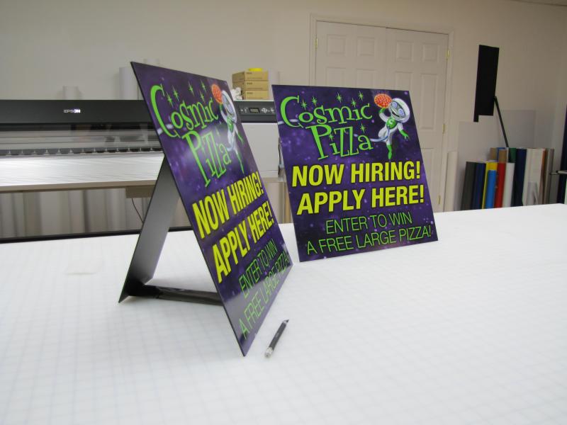

I just make another small rectangle from scrap sintra, then use scrap vinyl to make the hinge & bottom piece.
