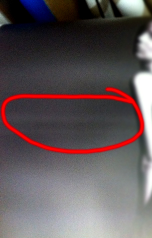

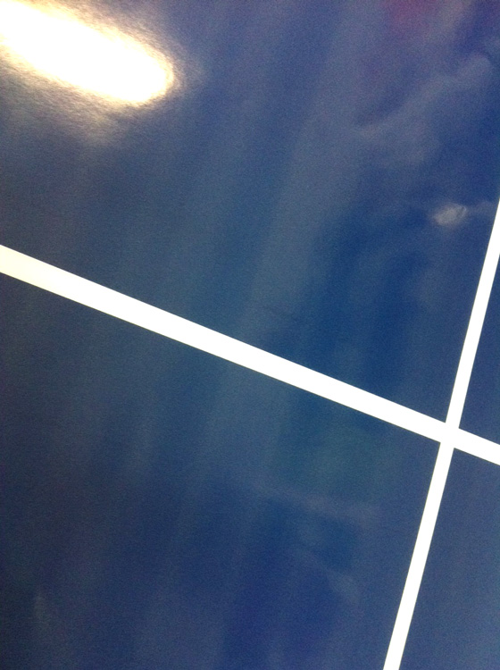

I'll post a couple of pics too.
Custom_Grafx
Here's a couple of samples...

GAC05
Quit buggin' me
What media are you printing on?
Have you been able to get good results on similar jobs with it before?
I don't have a Roland but have hit this before with my vj1304.
Seems that some materials just would not print good solid blocks of dark color.
Others are almost flawless even using a lower quality(faster) setting.

Custom_Grafx
Yes it's somewhat a phantom issue... but I want to find that phantom when it's 4.5 metres and 90ml ink that goes down the drain when it appears 3.5m into the print.
In the samples posted, the blue is a gloss clear, and the other is matte polyprop... so material doesn't matter.
It's not a consistent pattern either... the only consistent thing about it, is that it's random and intermittent.
I have also wondered about the number of pinch rollers... I use 2, even on 1524mm media, I tried using 4, but I could see a mark on the solid when doing that so went back to 2 again...

Custom_Grafx
Ok, so the tech just came and left. He found that the capping station wasn't straight so it wasn't sealing properly, causing ink starvation.
He straightened it and gave it the all clear... now I just have to try printing some dark solids again.
Hope this has fixed the problem.
Rooster
Less heat allows for a little more ink bleed, same thing with higher ink limits.
Usually ink starvation is usually related to the dampers. Since the capping station has no bearing on the delivery of the ink once printing, it's unlikely to have solved the problem.
Switching from bi-directional to uni-directional is usually a quick and dirty way to see if your experiencing ink-starvation. Epson piezo heads are notorious for it at faster speeds and especially with darker deeply saturated colors. A higher number of passes will also lay down less ink per pass (in addition to smoother screening) so it's also a good option to check for starvation.
Also make sure your machine is sitting perfectly level. The ink is gravity fed for the most part, so if you're forcing it to flow up hill it will naturally cause a restriction in flow.
