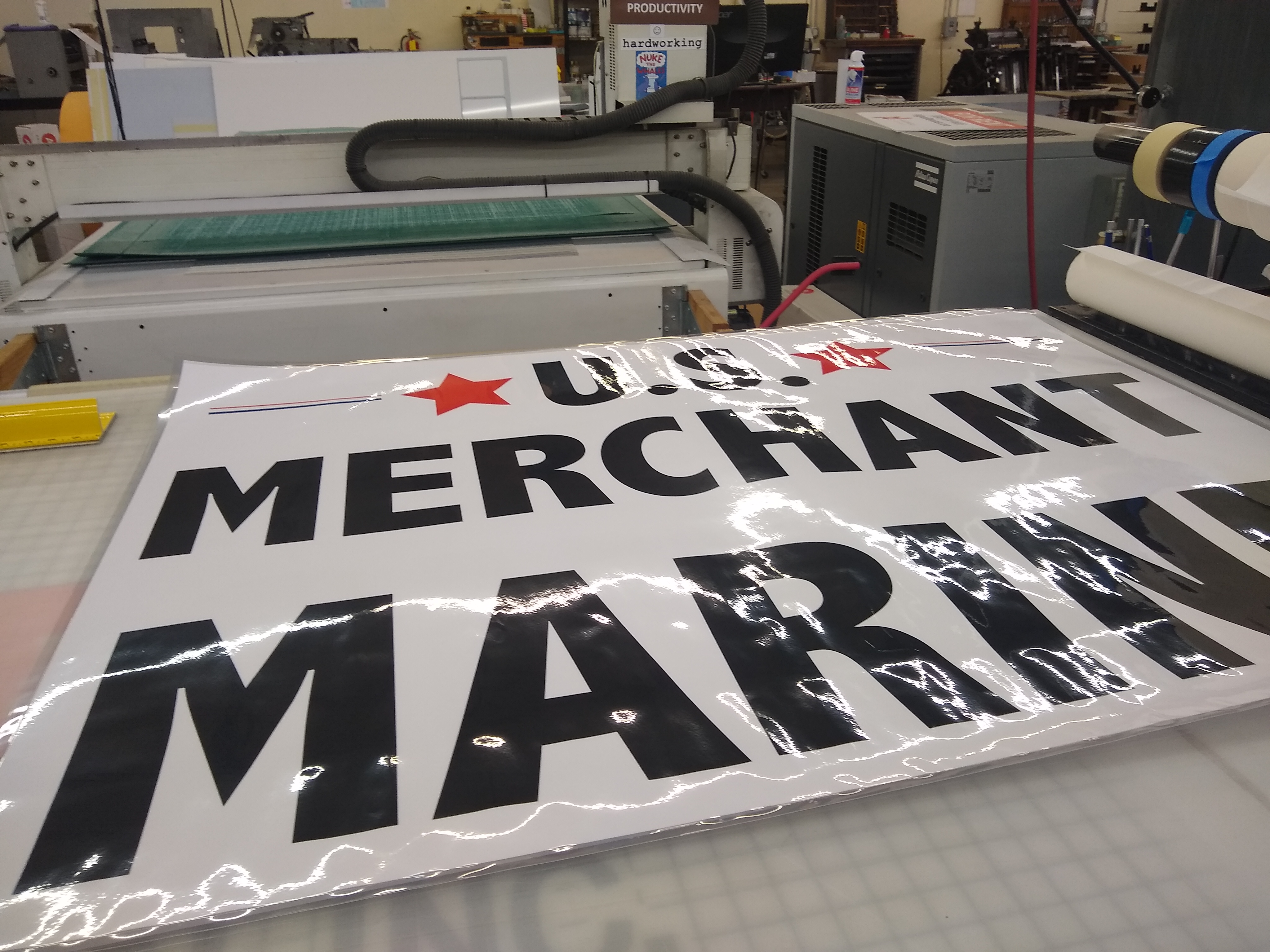

HP Latex 360, SIHL 3689, Remington 5 Mil Gloss Low Temp Laminating Film. The humidity has shot up and temp has gone way down in the last week, if that matters.so many variables, what printer? media? what film laminate? looks like graphic is curling up...if so to much brake on top roll of lamination film. If its all warped( I cannot tell) speed / heat / nip issue

I'm gonna say humidity in the paper stock, or just humidity in general. Is this in a controlled environment?

I have the pull/chill bar, but I do not have the attachment that keeps the chill bar cool. However, I was under the impression that was only for long encapsulating runs, which I never do. This was three 3x4 foot posters. Could lowering the temperature help?what laminator do you have?
do you have pull rollers on your laminator with a chill bar? It appears that the laminate isn't being pulled tight after the hot lam is adhered to the print...this can cause the laminate to warp as it cools back down. If you don't have pull rollers, then have someone pull the laminate from the back side so it is flat while it cools.
If you do have pull rollers, then you should have a chill bar and make sure your prints are tight to the chill bar to take the heat out as quickly as possible.

Not wavy at all. That would make things easy. That's now how this works.Customer induced issues, very familiar. I too have a soft spot for vets, and would likely bang my head against something similar. Have you presented it to him yet? His original posters may have been just as lumpy, therefore perfect in his eyes.
You are going down the right path. Either run the same temp but faster or reduce the temp and run the same temperature. Use the chill bar regardless....it helps to keep tension on the film as it cools down, too. It's just a heat-sink.I have the pull/chill bar, but I do not have the attachment that keeps the chill bar cool. However, I was under the impression that was only for long encapsulating runs, which I never do. This was three 3x4 foot posters. Could lowering the temperature help?

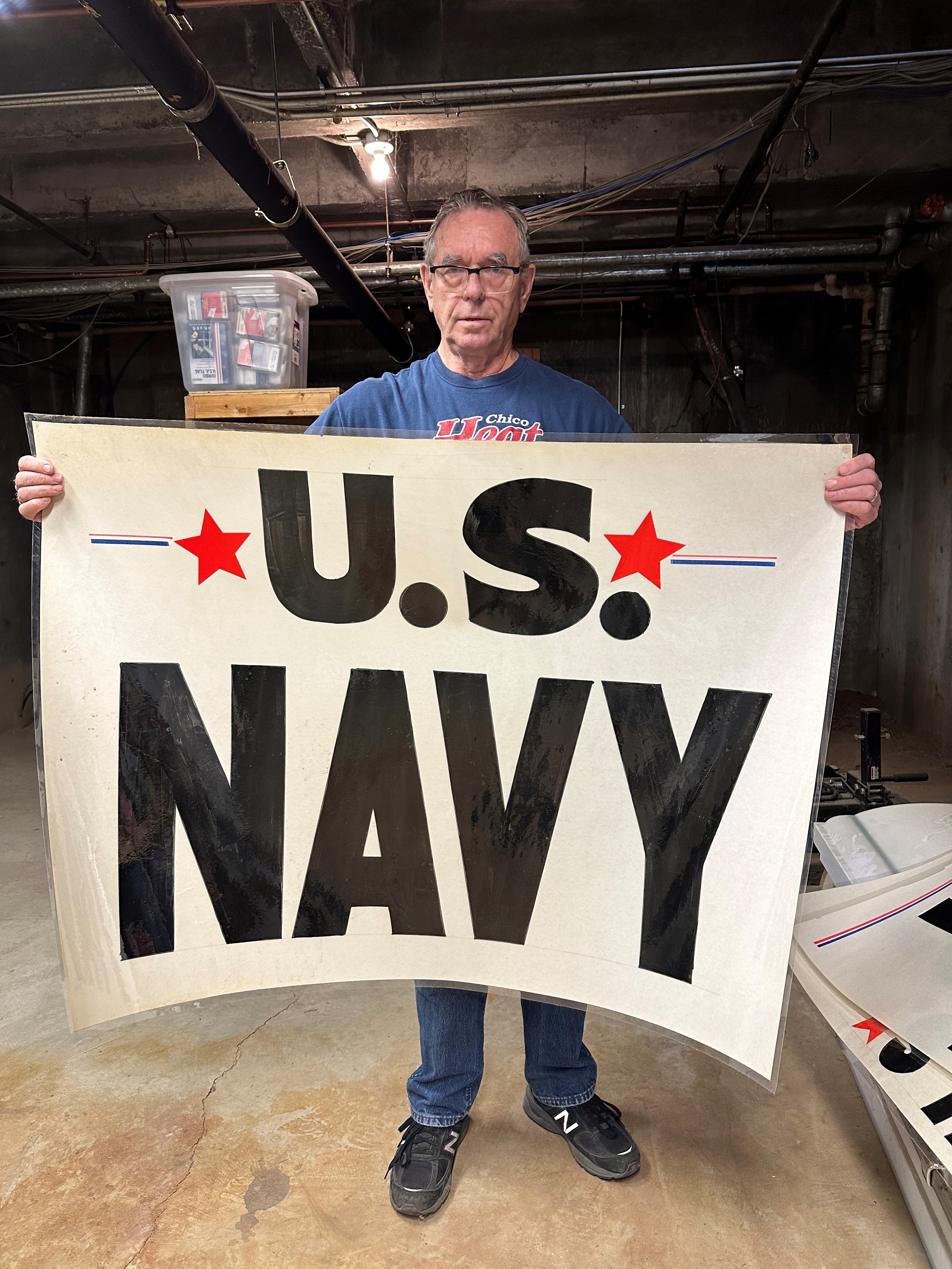

That is an image of him holding one of the original posters. Note they are hand painted. No waves in them. They do have a lot of curl, though.Ugh, he looks wholly unimpressed by your first attempt! Also looks like a much stiffer laminate than something for vinyl?
As far as hand lettering goes, you could always print, then paint over the lettering, add the base lines and defects you see there...
I could probably paint them, but it is something I have never done before. I also despise painting. Granted it was commercial painting I did before, not signs, but still. Bad memories. I once dropped a gallon of paint in someone's carpeted living room. We had plastic everywhere but a whole gallon will find a gap.I think you should create a light gray outline and paint them! I love the look of the brush stokes on the black. Can you back it with tag board to make it more stiff? Not sure if that would help the laminate wave or not.
Thank you for the advice.You are going down the right path. Either run the same temp but faster or reduce the temp and run the same temperature. Use the chill bar regardless....it helps to keep tension on the film as it cools down, too. It's just a heat-sink.
Even better, it's not like he'll care if it isn't perfect, in fact that's why he likes his old ones...I think you should create a light gray outline and paint them! I love the look of the brush stokes on the black. Can you back it with tag board to make it more stiff? Not sure if that would help the laminate wave or not.
