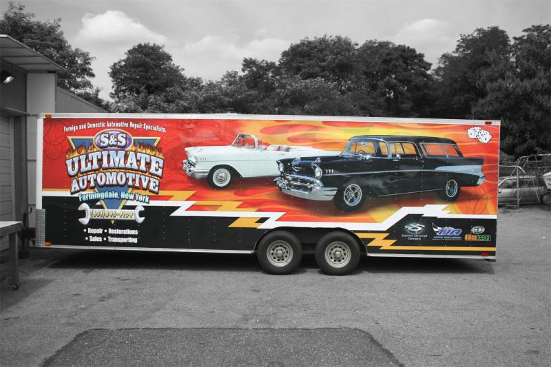

This is a project that we have coming up next month. It's for a custom car shop owned by a friend of mine who is working on my 65 Riviera GS. No screws or rivets on this one, just one row of those big ass plugs.

you HAVE to REMOVE them. They are screws and NOT rivets. The angle of the SCREW is not the same as a rivet which makes them harder to wrap (still dueable if you want to) and the "hole" where you put your tool to remove it will enventually crack and peel, and you will have failure all over the trailer. Though its a very small hole the vinyl is still tented over it and gets dry and will crack.
We remove them ALL the time...it goes quicker then you think. (see attached pic)
