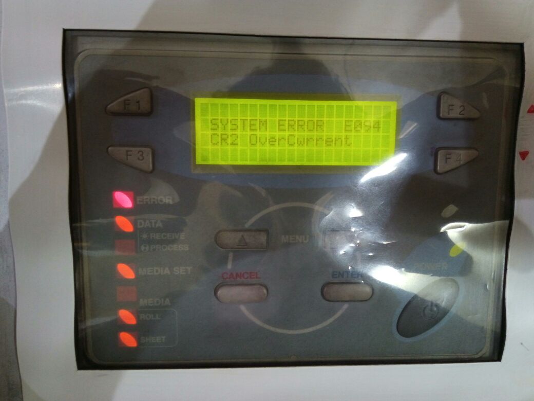

Eo94 cr2 overcurrent error in mutoh toucan
TeddyBear
Eo94 cr2 overcurrent error coming in Mutoh toucan printer,its coming during both printing and media initializing time, and there is bad noise coming from CR motor.I cleaned t fence

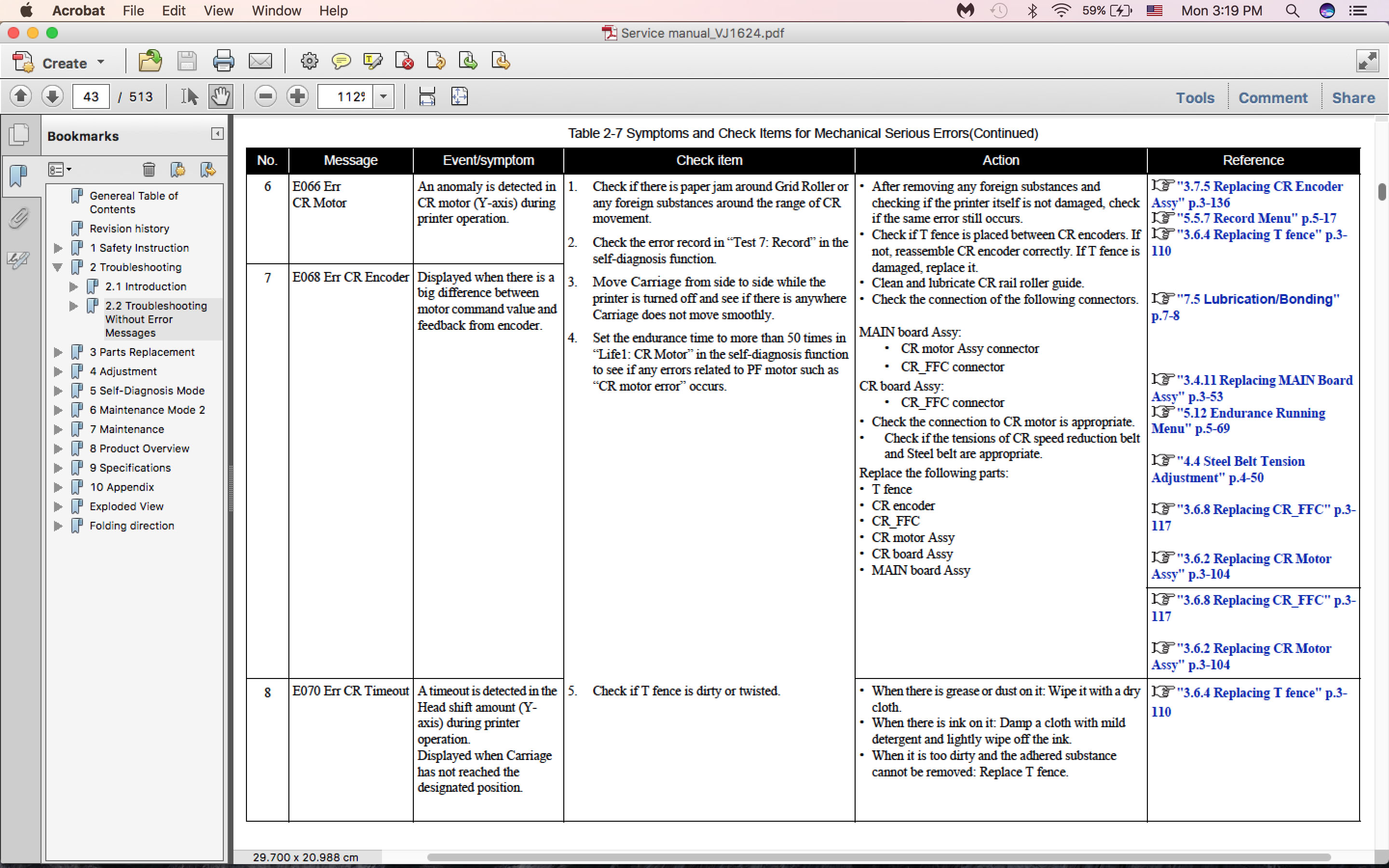

The possible causes are as follows:
1- Clean encoder strip
2- The is something blocking carriage movement
3- It's time to replace CR motor.
Most of the times it happens to me on VJ1624, cleaning the encoder resolves the problem.
TeddyBear
Since today morning error changed to e068 CR encoder,whenever turn on the printer this error coming, there is no pblm with CR encoder sensor
