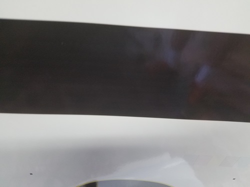

Hey guys,
Well I bought this GS6000, The nozzle check looks good,the print head alignment is good, but on all my solid color prints I am seeing a slight horizontal banding, on other lighter prints it only shows up in the black ares of the image.
I made a print of a green large mouth bass and you can see it at all..
Im stumped,,
Do any of you printing experts have any tips on how I could fix this or what to check ?
Thanks
Maxon70
Jason,
Thanks for the reply, attached is a pic of the banding,,
Maxon70
Have you changed the dampers? looks like starvation...
Negative, I haven't replaced the dampers, I did however increase the dpi to 720x720 and it seemed to fix the issue....
Thanks for your replies, the starvation symptom you mention made me think of increasing the dpi and it seems to of fixed the problem..Im still learning this printer...
