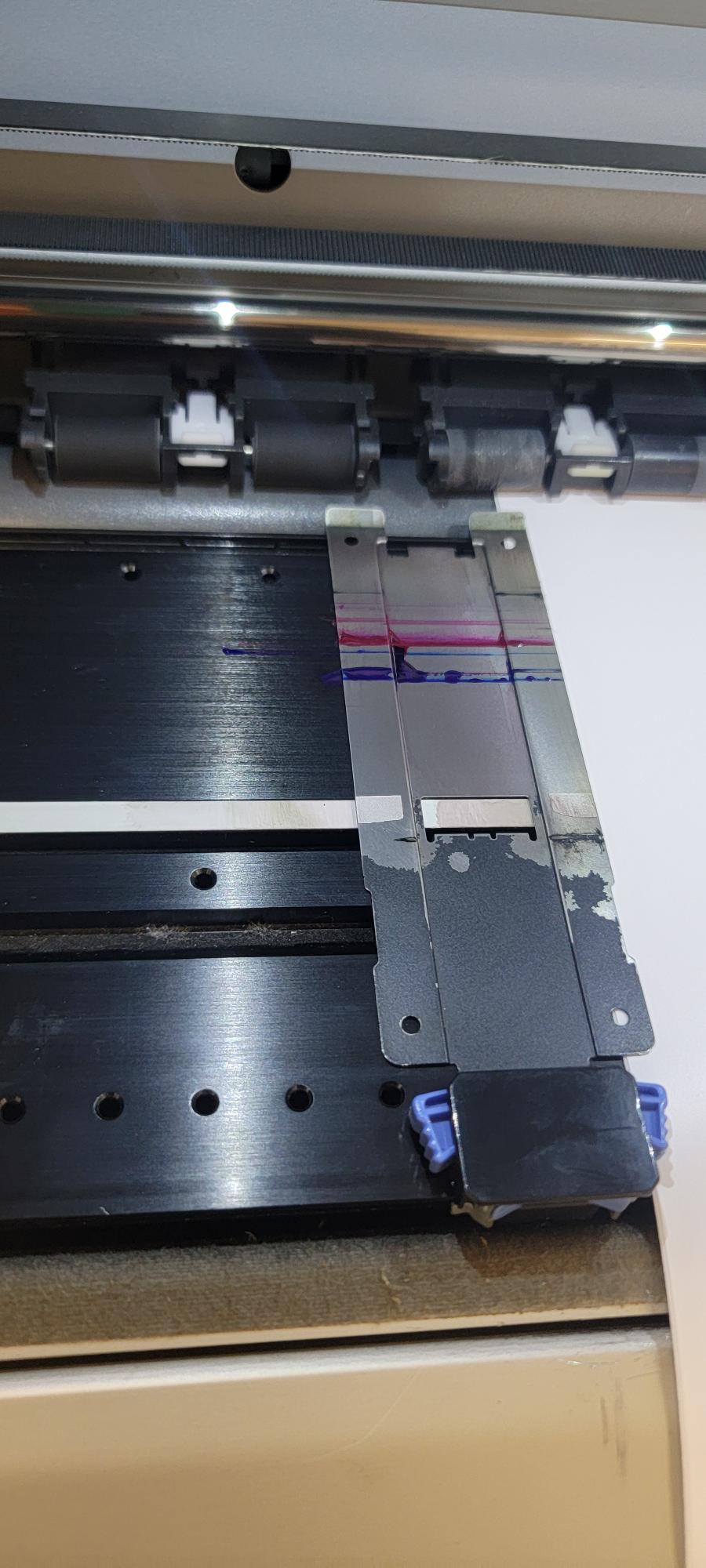

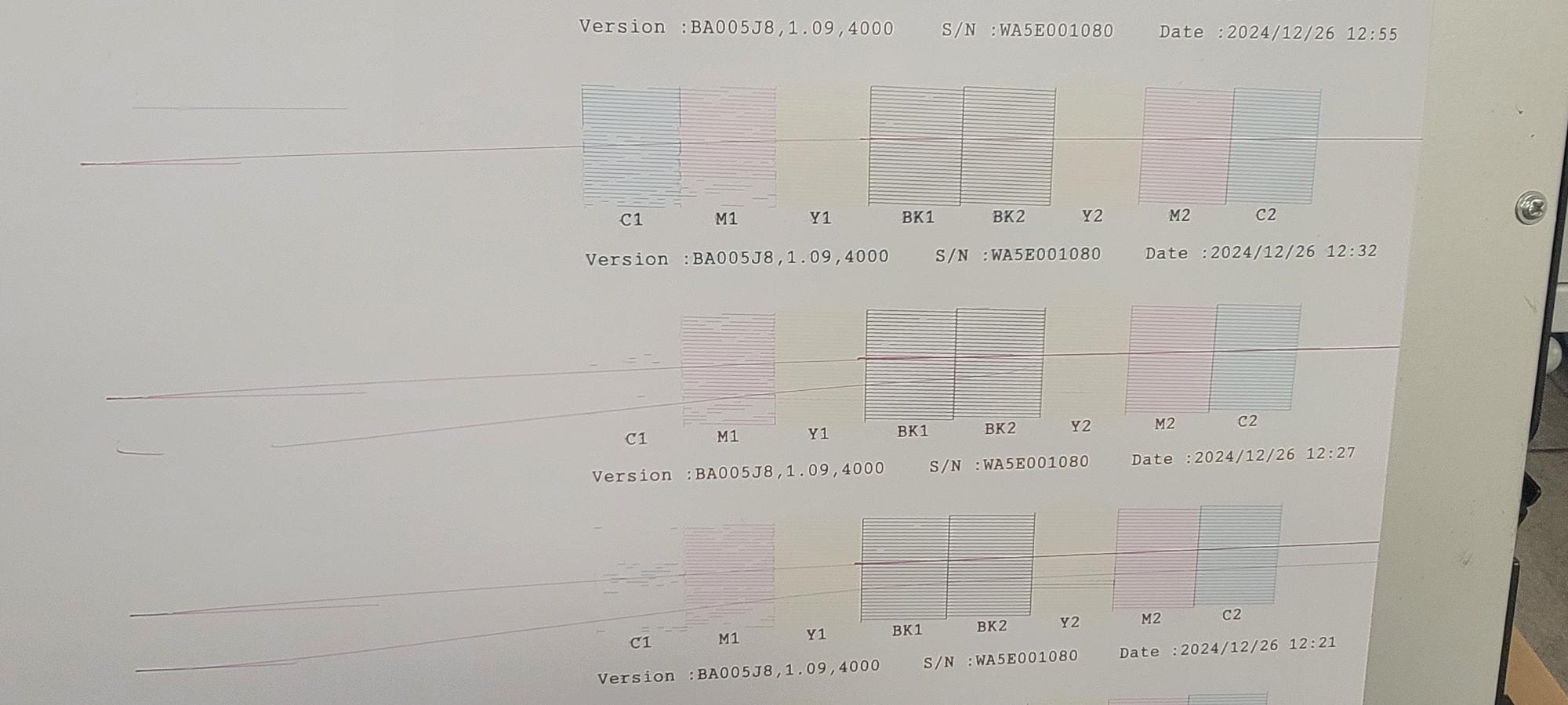

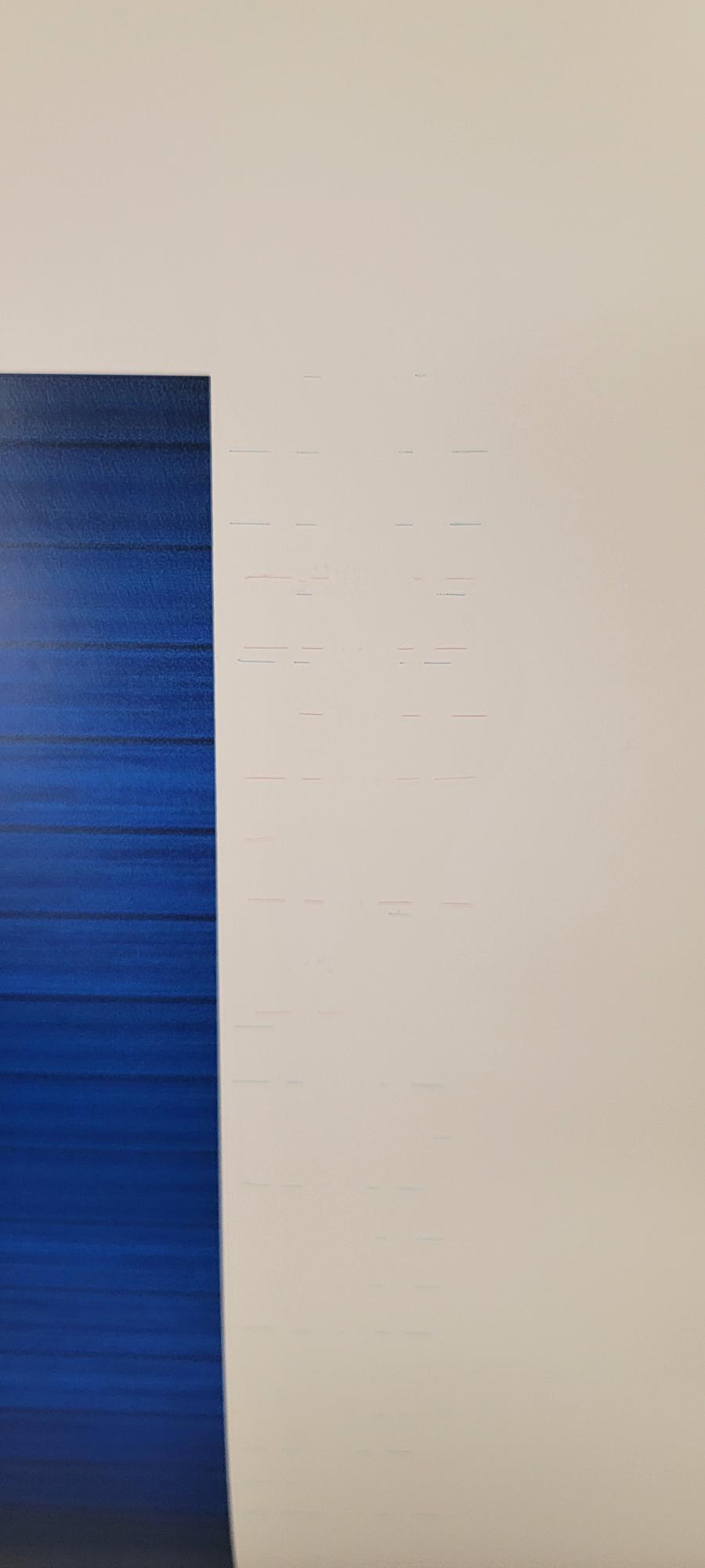

Does anyone know why the Epson is printing this Magenta line like this every time? IT does it will normal printing and doing nozzle checks. I tried doing a head wash along with manualing cleaning it countless times and it keep doing it. Any help would be greatly appreciated. Photo attached.

I'm an Epson authorized tech. Cyan and magenta, I believe, share one lane or small cap on the pump cap assy. Your nozzles look to be missing those two colors. I would suggest that this is a pump cap issue. I would clean the face of the head, clean the cap with a generous amount of cleaning fluid, I believe it is the far left on each pump cap. You can tell by the color residue. If not the pump cap should be replaced.. I can help with that if you need.
