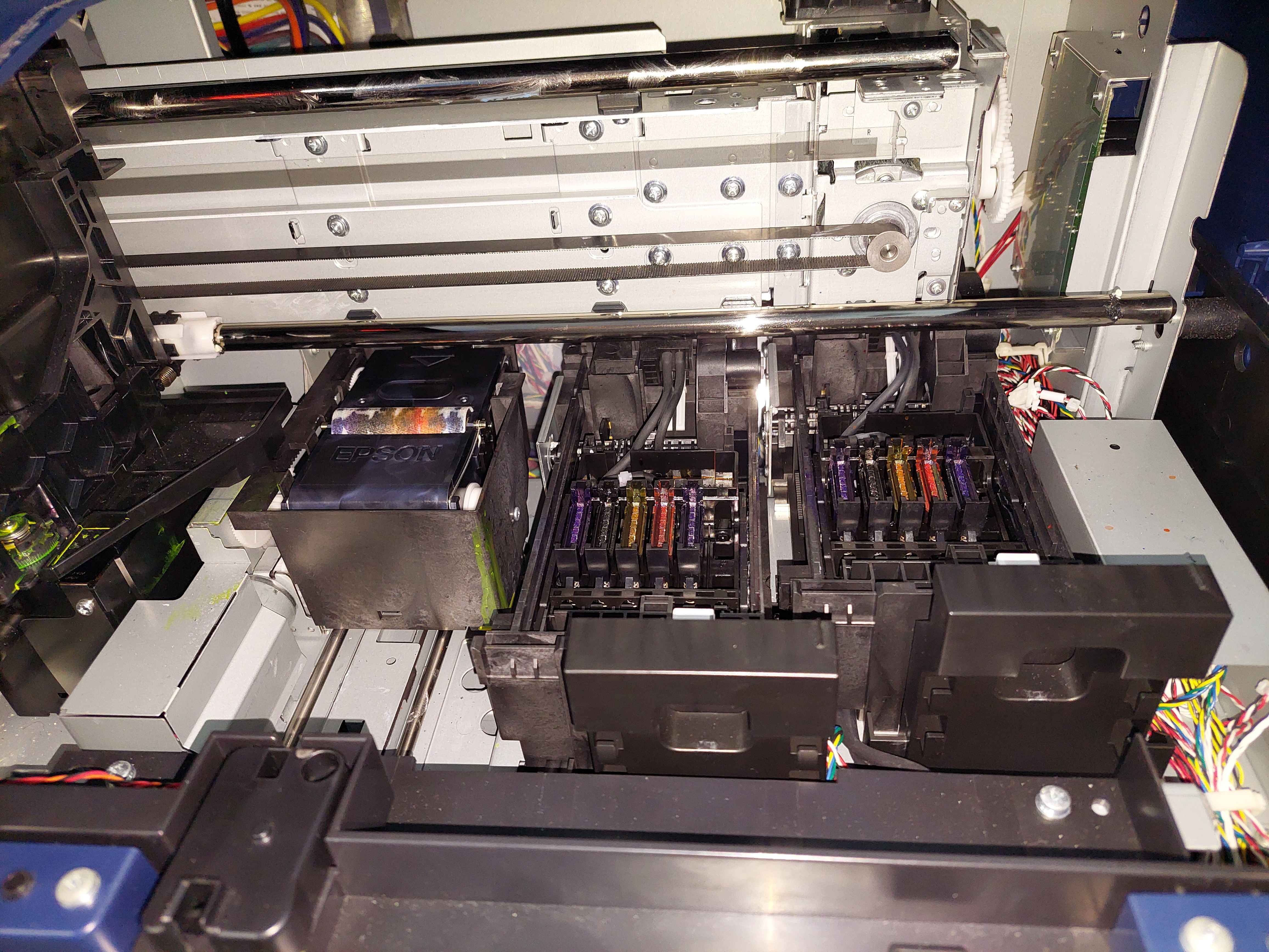

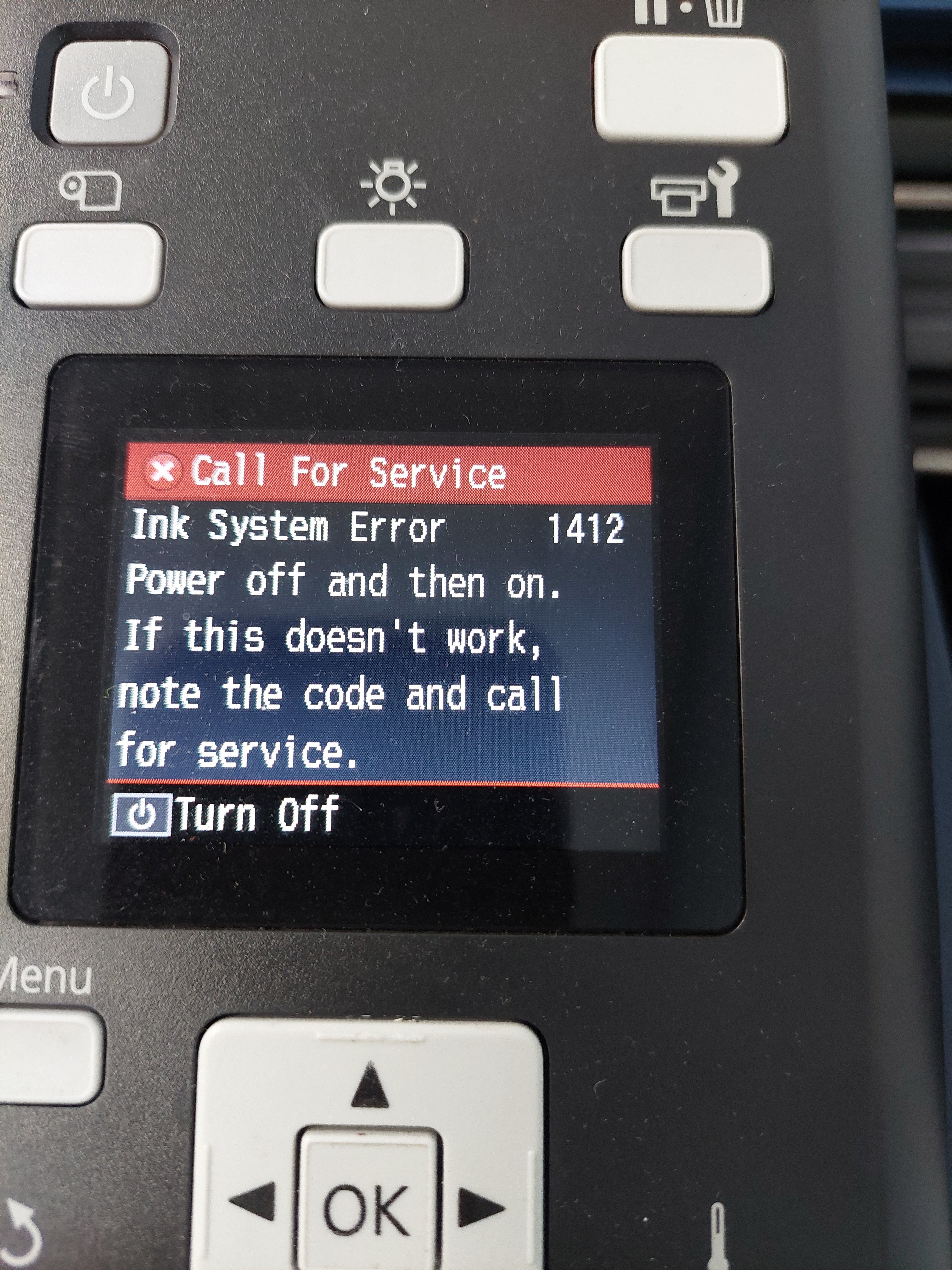

CHANGE MAINTENANCE, WIPER, PAD, ETC...NOW DOES CLEANING ERROR 1412 TO SHUT DOWN. NOT SURE IF ITS WIPER DOING IT BUT DONT SEE ANYTHING WRAONG 20241115_203213.jpg 20241116_085141.jpg
petit
Firsty you 'd better clean it right because it's kind of dirty here then search the error code on the web, should find some clues

I have a DCS 7200z, which is built out of an Epson 7900
In my error code book
1412: "Ink system error, Pump, Pump Life error; The number of pump counter has reached the specific upper limit. (pump motor's life (ink system unit's life)) Replace ink system unit and clear counter using the service program."
WeFixPrinters.com
Merchant Member
If it is using EPSON firmware you will need the adjustment program which EPSON supplies to us service centers.....there are bootleg copies on ebay
The pump cap assy is around $275 if you want to be proactive and replace, they do wear out, unlike many of the other parts that may come up as to be replaced
