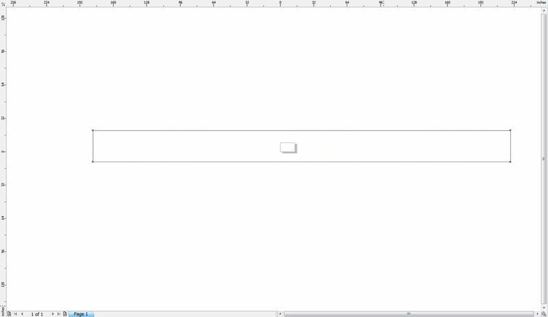

well, I just tried to 'publish to pdf' a 13"x400" red box from corel, using 'selection' as page size, from a 8.5"x11" page, and what I got was a blank 13"x200" pdf
edit: it imports back in just fine, but that's beside the point. the pdf comes out blank, and 200" wide
Andy D

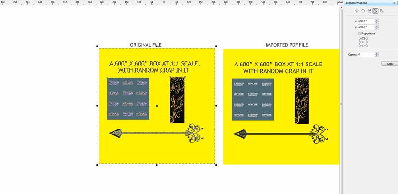

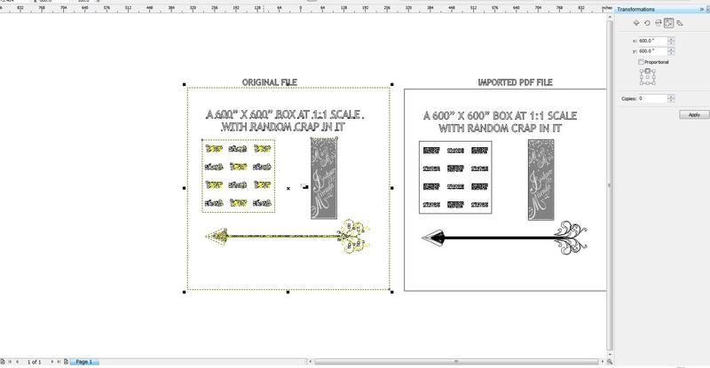

I don't know what to tell you, it works for me......

J Hill Designs

Open the pdf and see what it looks like.
I just did the same thing. publish to pdf 800x800 with random crap. the pdf turned out to be .04"x.04" and blank, but imported back in exactly as published.
I'm not saying the data isn't there, its just the the PDF SIZE doesn't come out right.
Andy D
Which just so happens to be the OP's problem TO A TEE.
