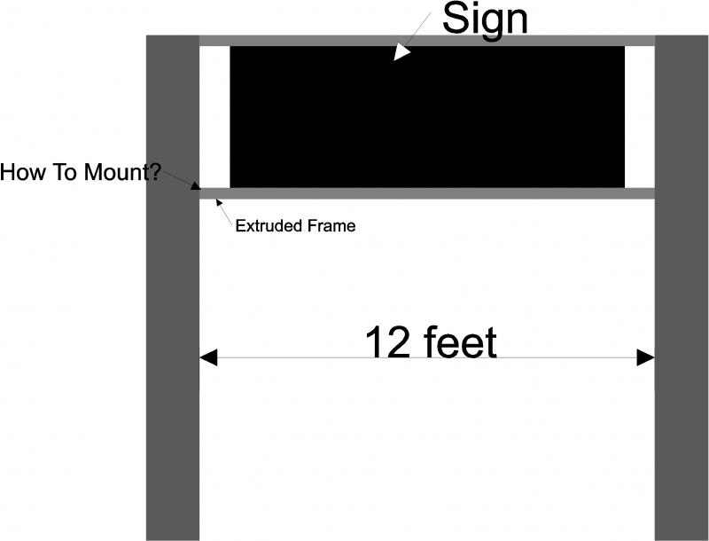

I have attached a drawing of what I am looking to accomplish.
My customer has a large garage door that he would like the sign to occupy the top portion. The width is 12', I am looking for something that can hold the extruded frame and the wieght of 3mil Dibond between the two metal pillars fo the garage door.
Any help, thanks!

you may want to consider a thicker panel as it will be structural in this installation, just a thought...???
Also, signcomp.com has many extrusions available
Pat Whatley
What type of extruded frame? If you're supplying the frame have you checked with the manufacturer to see if they have mounting caps available?
