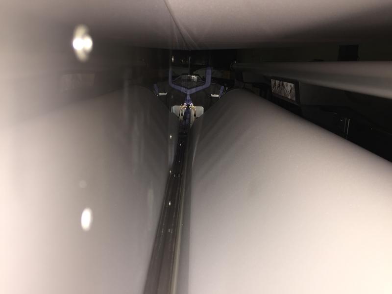

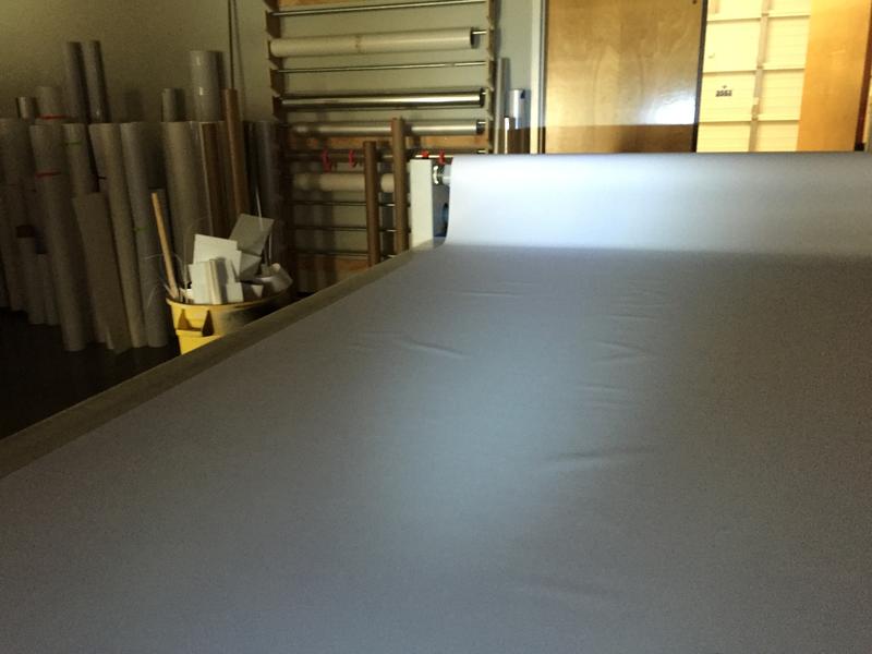

update. maxing out the tension and resetting the media after 20' did not work. still getting ripples. note the ripples seem to appear consistently in just one spot (which would seem to rule out temp or vacuum as the source of the problem). attached are a couple of pics. we're thinking that it might be a media issue. You can see that the media doesn't lay flat when you roll it out on the table and then also shows before it ever reaches the platen. Thoughts?

some more interesting observations...if we "pre-feed" the material (unrolling a few feet so printer isnt pulling it off the roll) there is no bunching at all and no head strikes...yea! the side effect though is that the material doesn't track well and is moving to the left creating a skewed print. (For this job it's not an issue as we're printing 36" on 54" material so there's plenty of material available on the sides). Could the printer be pulling it through at an uneven rate across the width of the material?

We have a 104" Mutoh Dye Sub machine and I had the same problem when I first started at this company. We ended up using stops to lift the pinch rollers on each side and one in the middle and it solved the problem. Later I found the manual that suggested lifting the pinch rollers on each side. Not sure if thats an option on the 360 though. Good Luck
