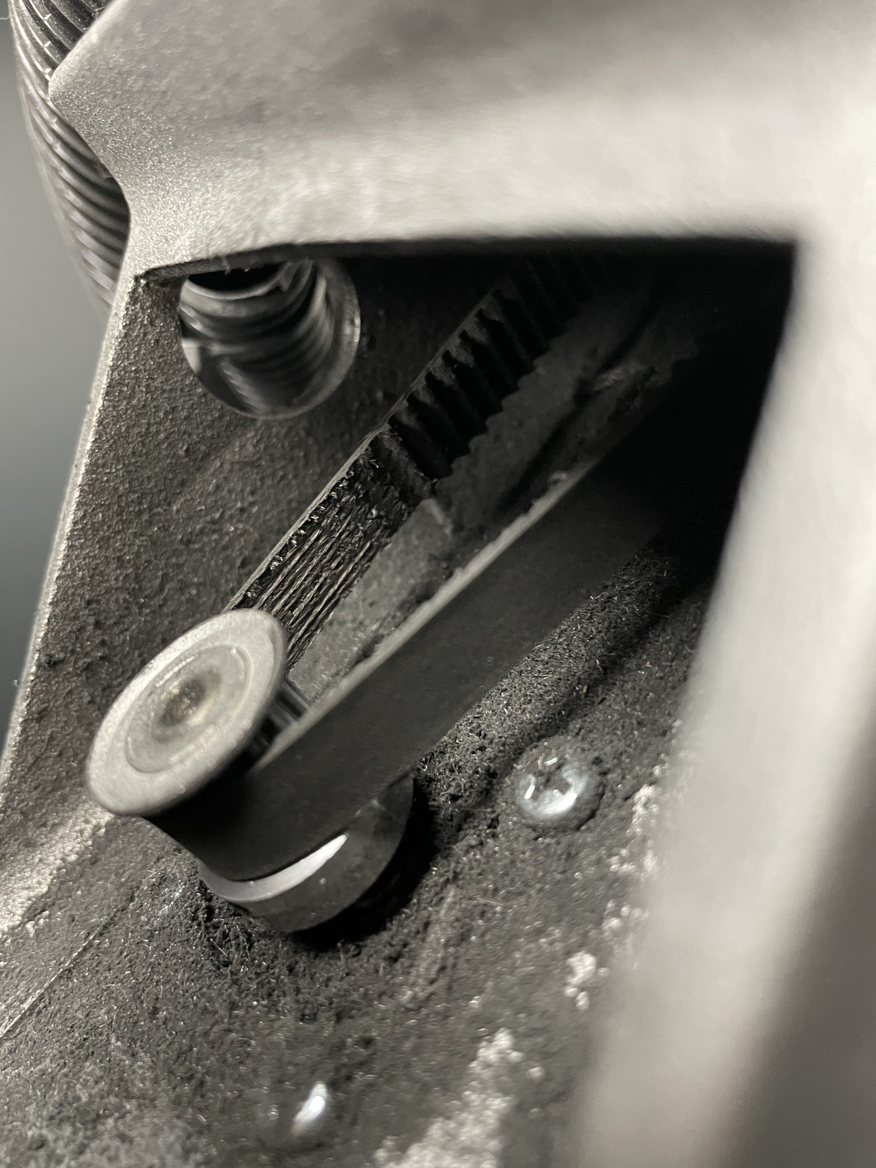

It varies ! At first the carriage was moving then squeeking and stopping , now it won't even move past a few inches. I cleaned the rails of all the grease and reapplied and that got rid of the grinding noise but it didn't help with carriage movement. I'm stumped lol my belt tension isn't correct according to the idle tongue so gonna try to fix that tomorrow
Check your gears for broken teeth.
Thanks ! Found the issue lol
