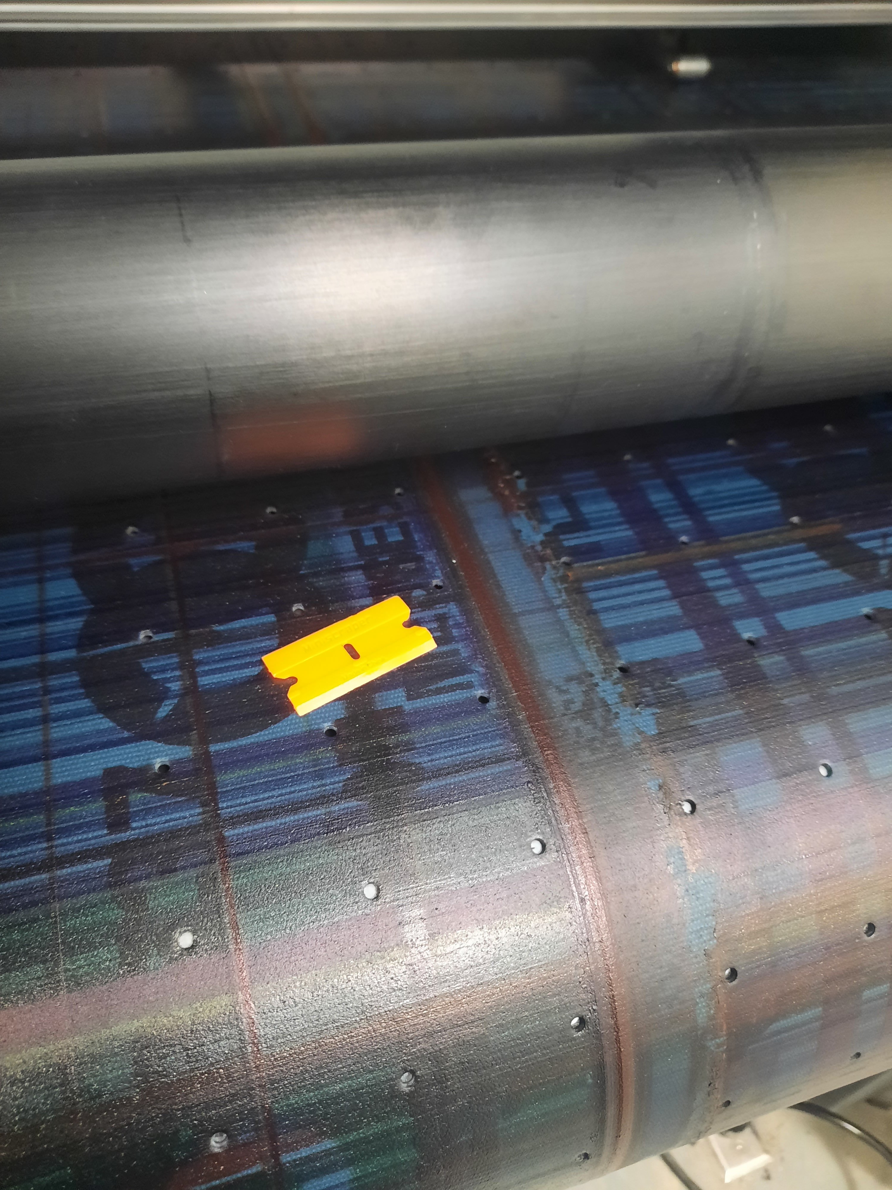

FB500 ink build up on belt
Dizzy385
Graphic designer
Hi,
What is the best way to clean the ink build up off the FB500 belt? Plastic blade seems to work okay but still kinda hard to get the ink off 20220114_150425.jpg
ikarasu
Buy some running alcohol. Spray a ton of it on the belt... Then put some plastic wrap, foam, or Coro or anything over too so it doesn't just evaporate. Let it sit for 15 mins and it'll wipe off.
Methanol works the best... But harder to get and it's more bad for you.
