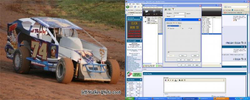

Go to your PM select cutter, click on setup>Default Job Properties>3rd tab over>Cutter Options. IT's in there to turn it on.
deckersupplyco
I looked there, there is just a tab for before job & macro. Under Before job all I can select is none, cut fast, cut slow, or pen plot. While macro just has test, light on, light off. Nothing else there.
DRPSignsNGrafix
Here are screen shots THis is where it's at
deckersupplyco
Ya, we're missing that tab. Must be some sort of software update that we haven't updated yet. We're running FelxiSign Pro 8.0v2, same as yours right?
deckersupplyco
Figured it out. We have Production manager on a different computer so we never thought to do the software updates on that one as well.
