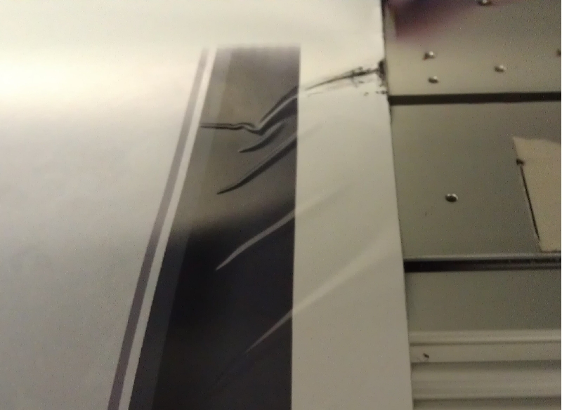

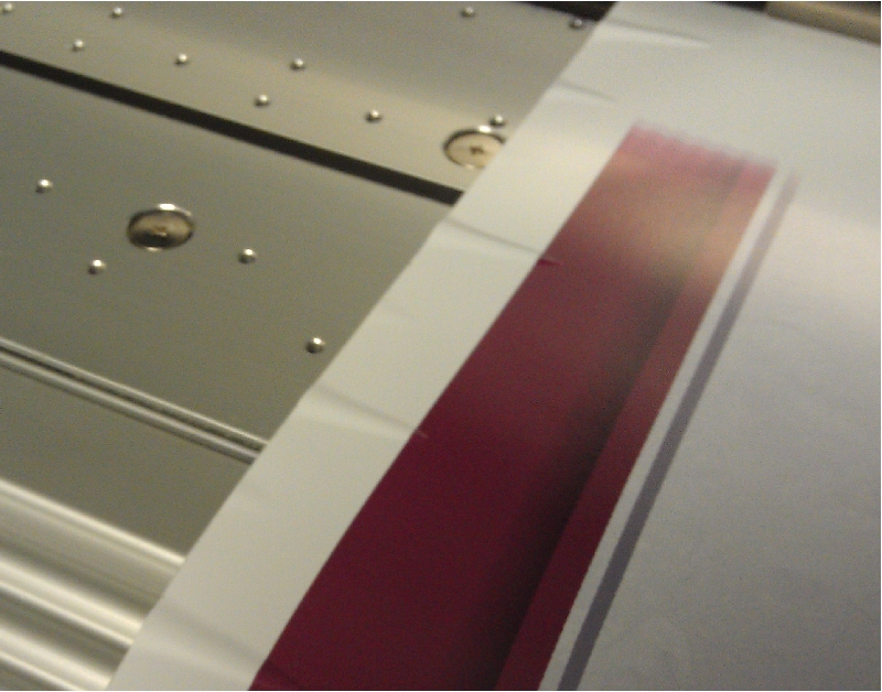

First time I've Used FDC (probably the last). Only used it because I needed a matte finish with air release, this is what supplier had.
When printing on Mutoh 1614 it wrinkles along the edges. I've turned heat on Pree and Platen heaters way down to 35 degrees. And if anything theat made it worse.
Anyone used this before or have suggestions?

Graphics2u
It look fine on the roll. Not a wrinkle to be seen. Thought it was too much heat at first, but apparently that's not it.
Cale Frederick
Solvex perforated does that to me a lot. Havn't found an answer though... Is the backing paper still flat or is it wrinkling to?
If your still looking for a great matte calendared vinyl, Avery 2923 EZ is awesome!!!
Graphics2u
Just the vinyl wrinkles. Backing stays flat. This roll is just garbage! I came accross a 6' section that has big blotches of adhesive missing from the back! Then about 8' feet farther into the roll there is a giant blob of adhesive that looks like it dripped on the vinyl side, about 2" wide and 12" long. Unbelievable! If I didn't need to ship out these signs tomorrow I'd throw the whole roll out! So I just keep trying to find good sections long enough to do the prints I need.

Cale Frederick
I have only ever used FDC cut vinyls and they always seemed very well made. I'm surprised that their print film would have so many issues. Hope you get it figured out!
D&Tgraphics
I don't know what is causing it but I do know that it's probably just crap material. In our shop, FDC is the "F" word. It's terrible.
the graphics co
isn't FDC just rebranded 3m product? That was my understanding at least.
I would return the roll as defective and hopefully that doesn't happen again.
