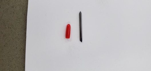

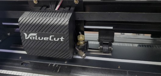

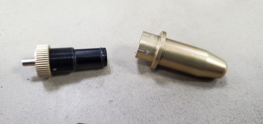

Our shop recently acquired a ValueCut 1300 (not the ValueCut II), and I’ve been trying to find the correct replacement blades. I ordered a set from US Cutter that were listed as compatible, but they seem too short and fit very loosely in the blade holder.
Now I’m wondering if either I ordered the wrong blades, or if the blade holder isn't the original. Any help or insight would be much appreciated.

The original value cut uses a 2 mm Blade it’s compatible with a GCC Roland cutter. If you go on eBay or Amazon and look up blades and Blade holders for GCC Roland they fit.
