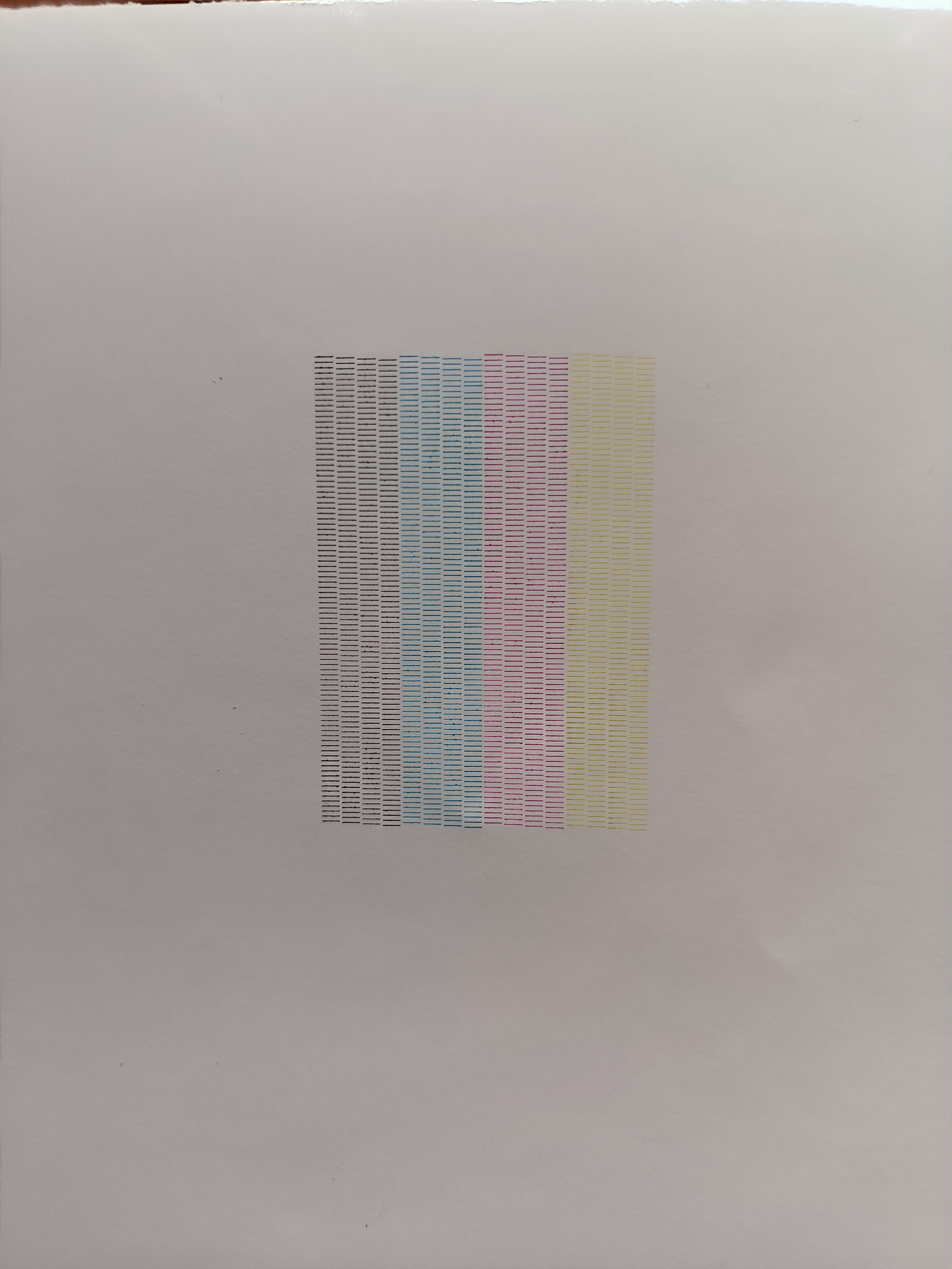

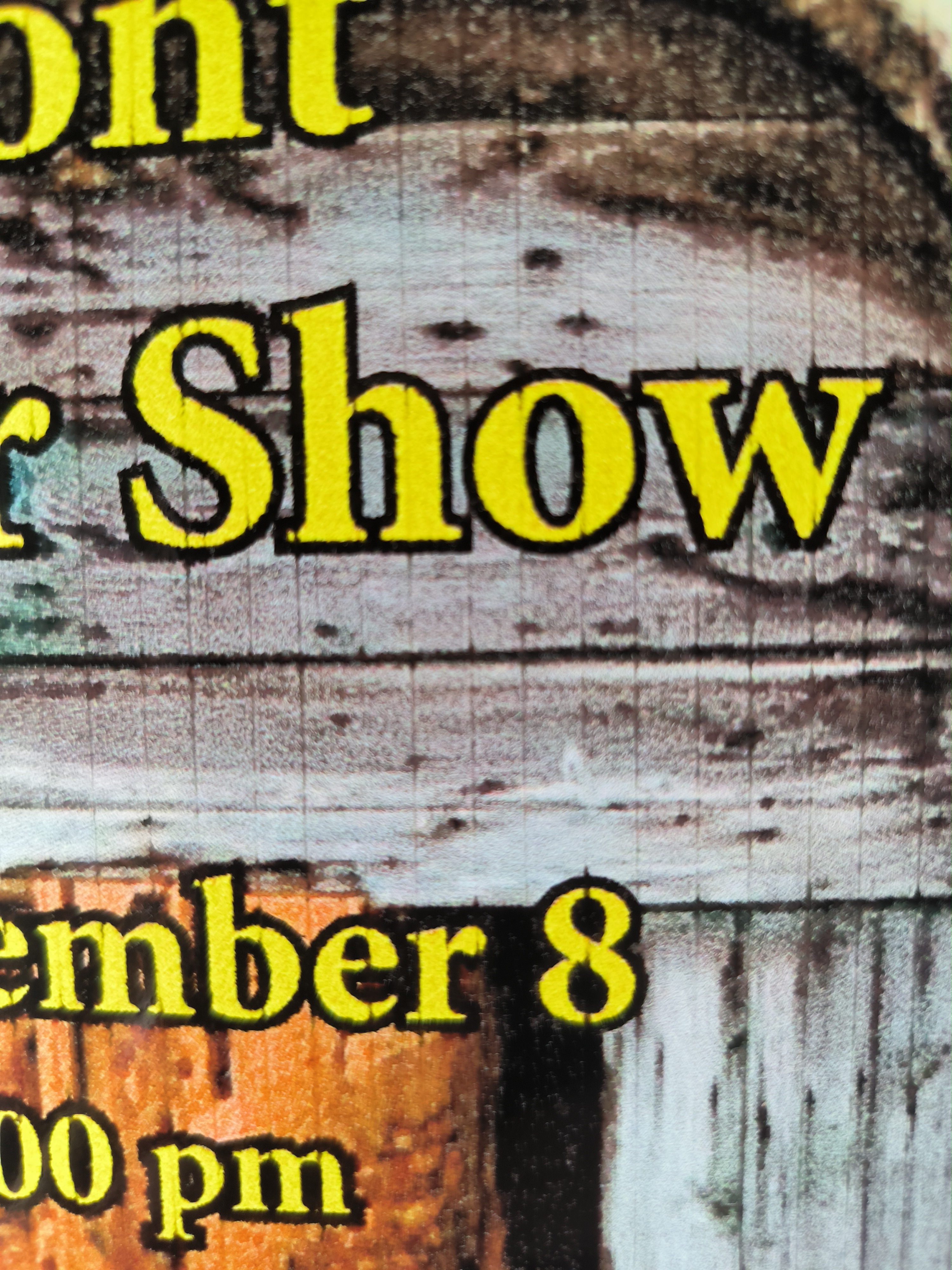

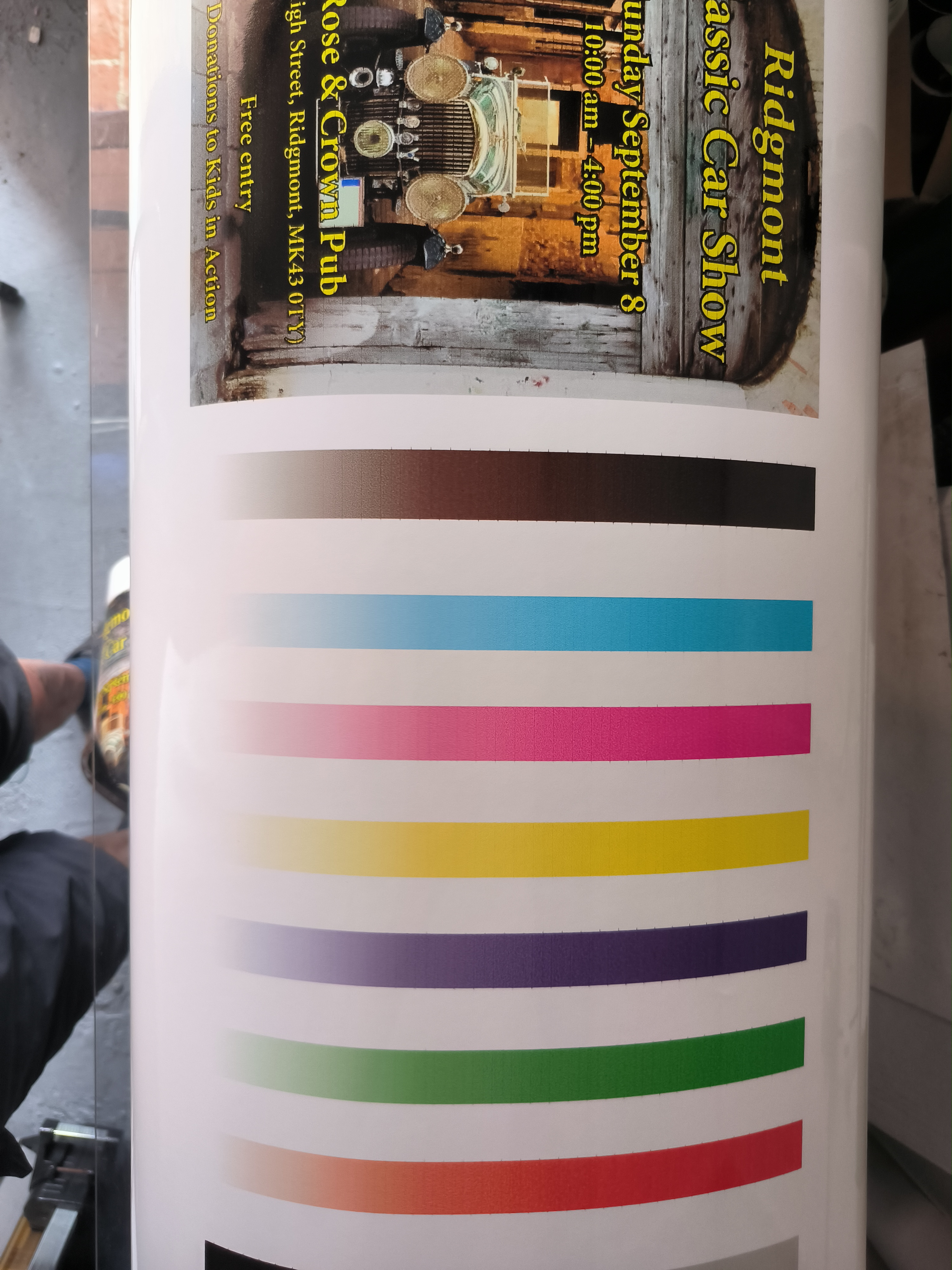

Hi, have you tried to clean the encoder strip and his sensor ?
I recently had a problem of magenta around the print and cleaning the encoder strip fix it.
I though encoder strip problem would always affect all colors but in fact it can affect only one too...
