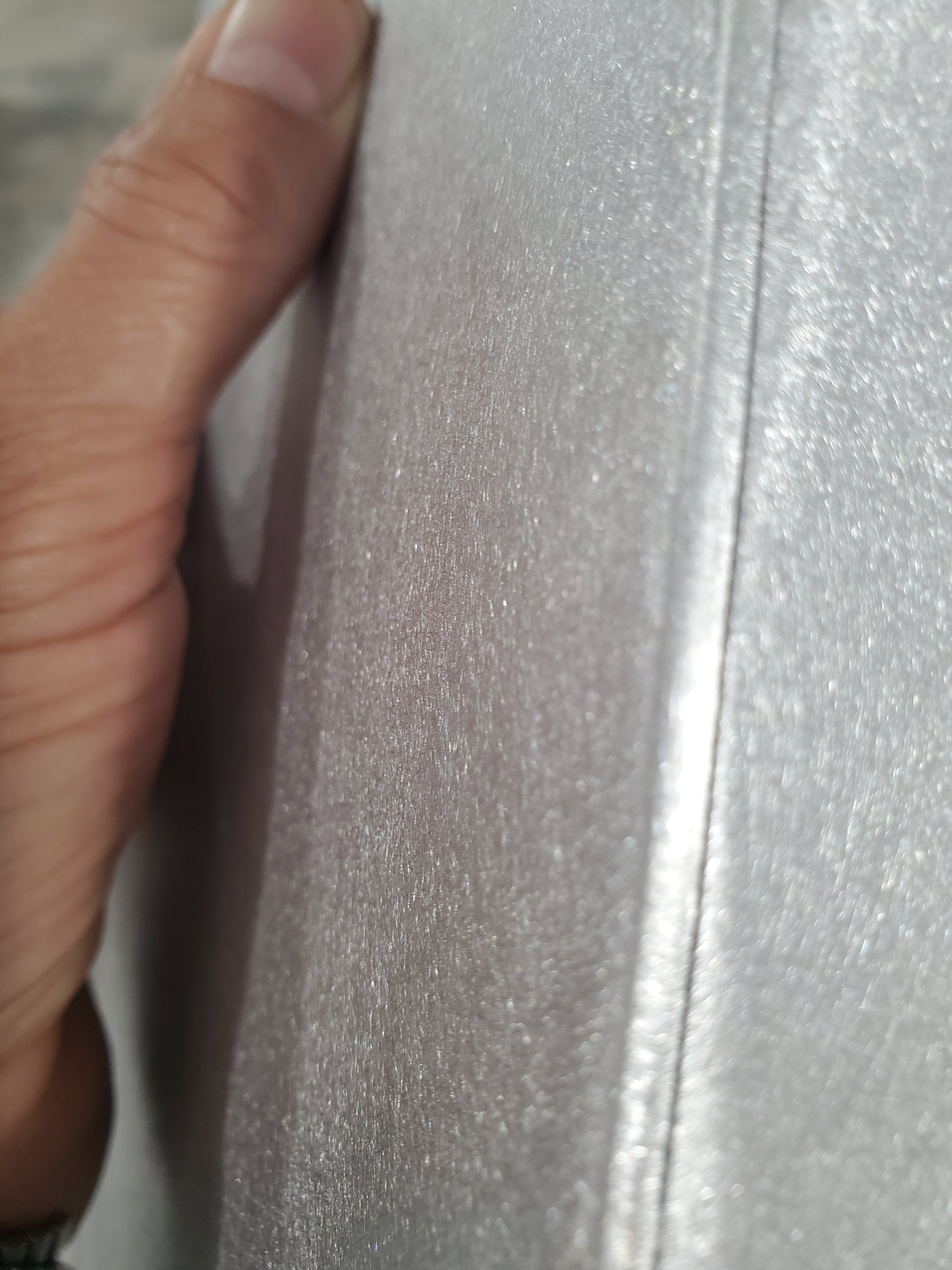

I'm looking for a faster method of finishing the edge of a reverse channel letter between the return and face. I don't want to see a seam in finished product. I've tried about 20 different kinds of gap fillers and have about 15 types of sanding devices but can't seem to find a method that is not labor intensive. I often have narrow openings in smaller letters that I need to be able to access as well. I'm curious how other sign companies finish these edges? I have not tried high build polyester primer yet. Curious what other companies do...

Filler and sandpaper are pretty much the standard unless you have the ability to cast them- which comes with its own finishing challenges. I say filler and sandpaper because we've produced somewhere along the lines of of 1,200 or so reverse letters so far this year, and every single one of them has gotten "body work" and sanding before painting.
I would sure love to hear/learn about a faster method myself, though!
I would think a 3D metal printer might be able to do it, but I'm not familiar enough with the technology to say for certain. Also not sure it would be cost effective, though it would certainly seem to be- depending on how fast it prints.

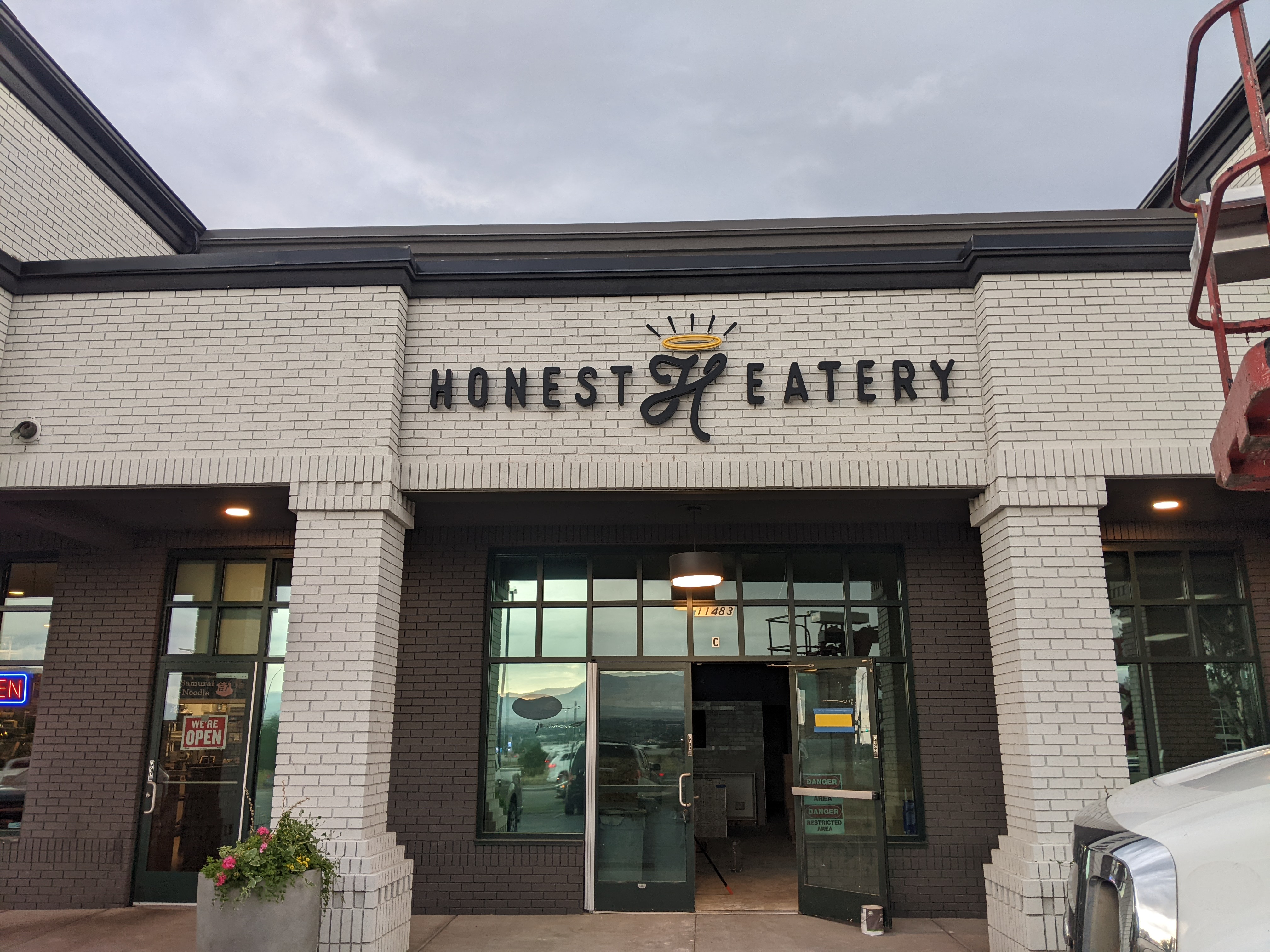

Are you welding or glueing the letters together? We weld them then sand the seams and caulk the inside of the seam to prevent light leaks. No filler needed. Just installed this set yesterday.

I think he's either nit picking or thinking of interior eye level installs where some form of 'perfection' is ideal. I know I'd be displeased when ordering reverse channel letters if the whole return had a little lip toward the front.
