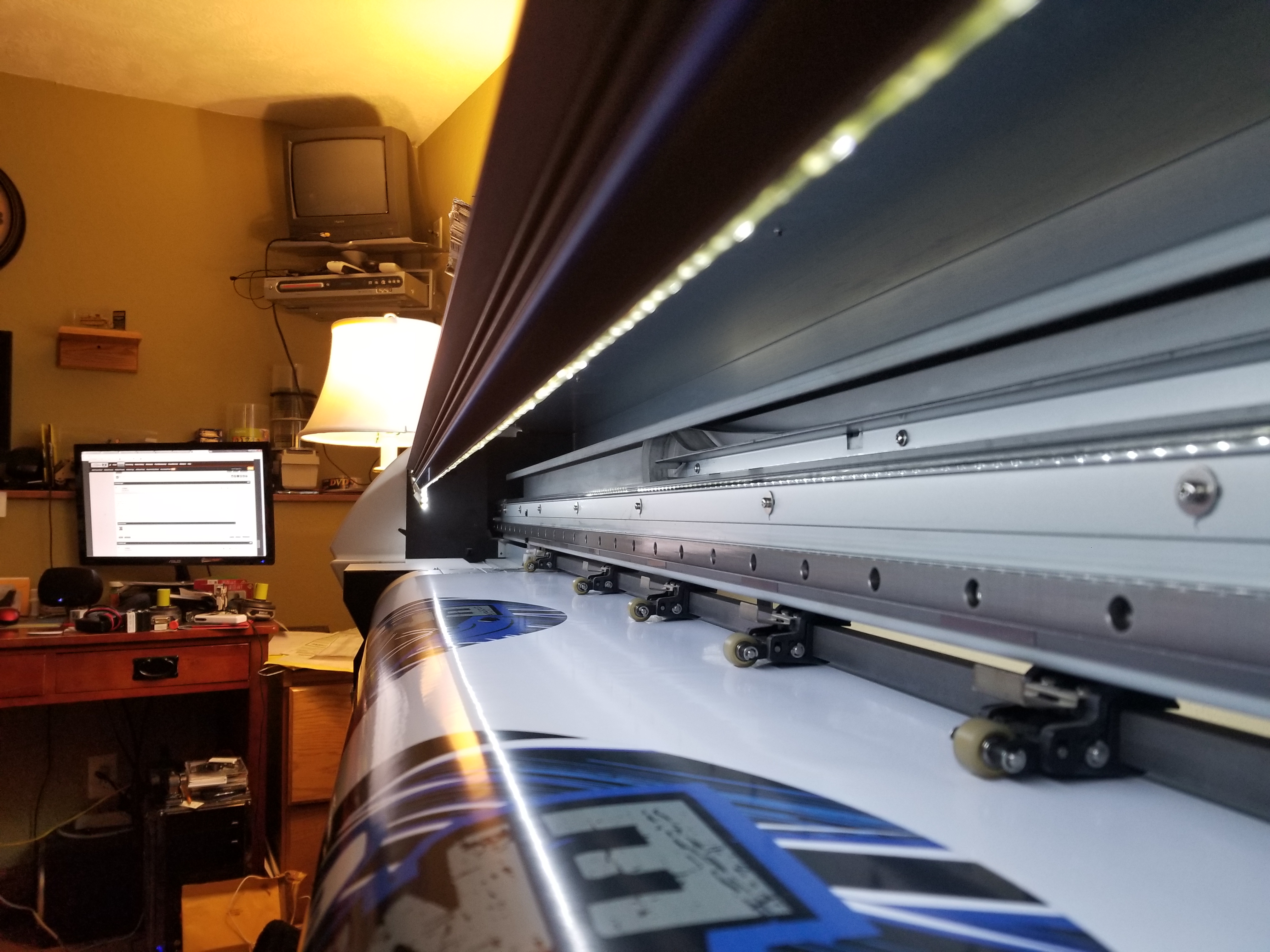

I have no idea why these dont come from the factory this way. But do yourself a favor and order up some led strip lights from china and create a whole new world. They all operate on 12v DC power
I have these in my service van in the car area, two 15' strips on the ceiling and its like daylight in there. These are so inexpensive and handy, put them anywhere. Use at home with simple old wall wart transformer or can buy one specifiaclly for it, i have so many laying around i just use what i have in the bin.

I put them under the lid of my xc540. For security I cut some laminate patches and applied over top of them to make sure they didnt come loose.

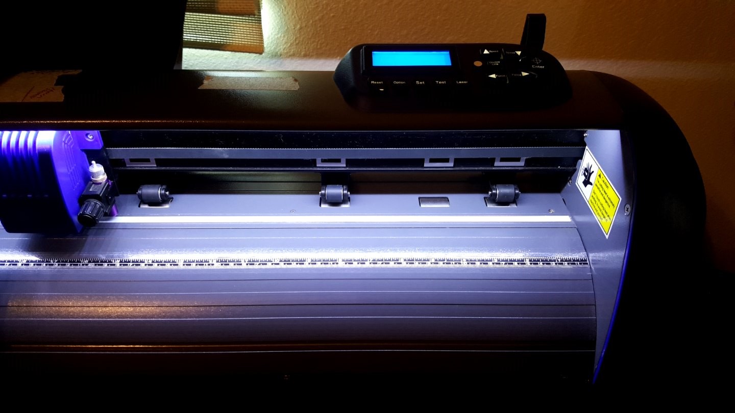

I did this a couple years ago on my Cutter, It has 3m adhesive and holds strong and provides amazing light to watch while things are cutting . I think it paid around 16 dollars for everything ,which included a 16' led strip and power supply on ebay.

Yes I just ran the cord through the machine and out the pack between 2 panels and into a outlet. Leave them on 24/7 for 3 years now.
