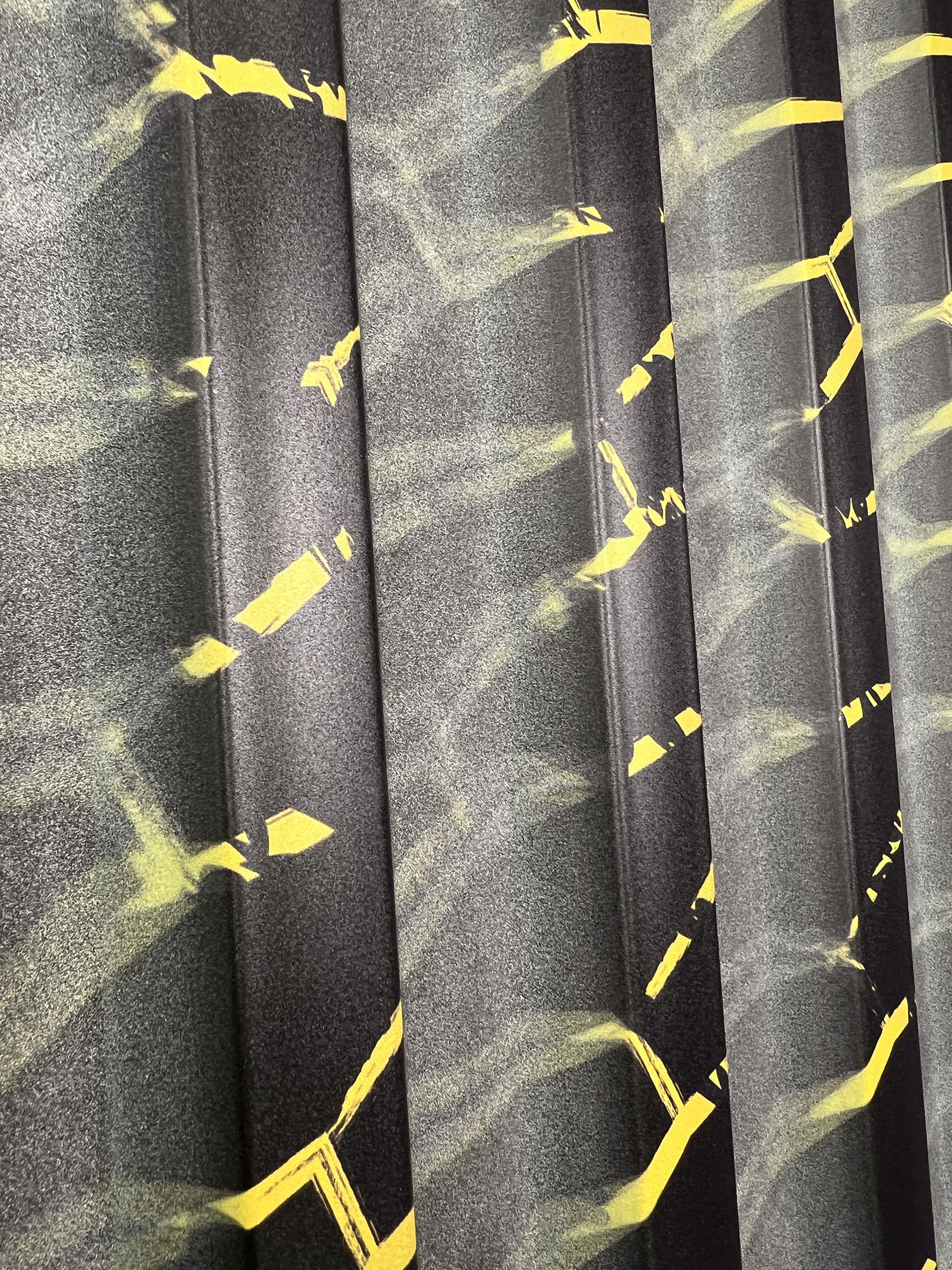

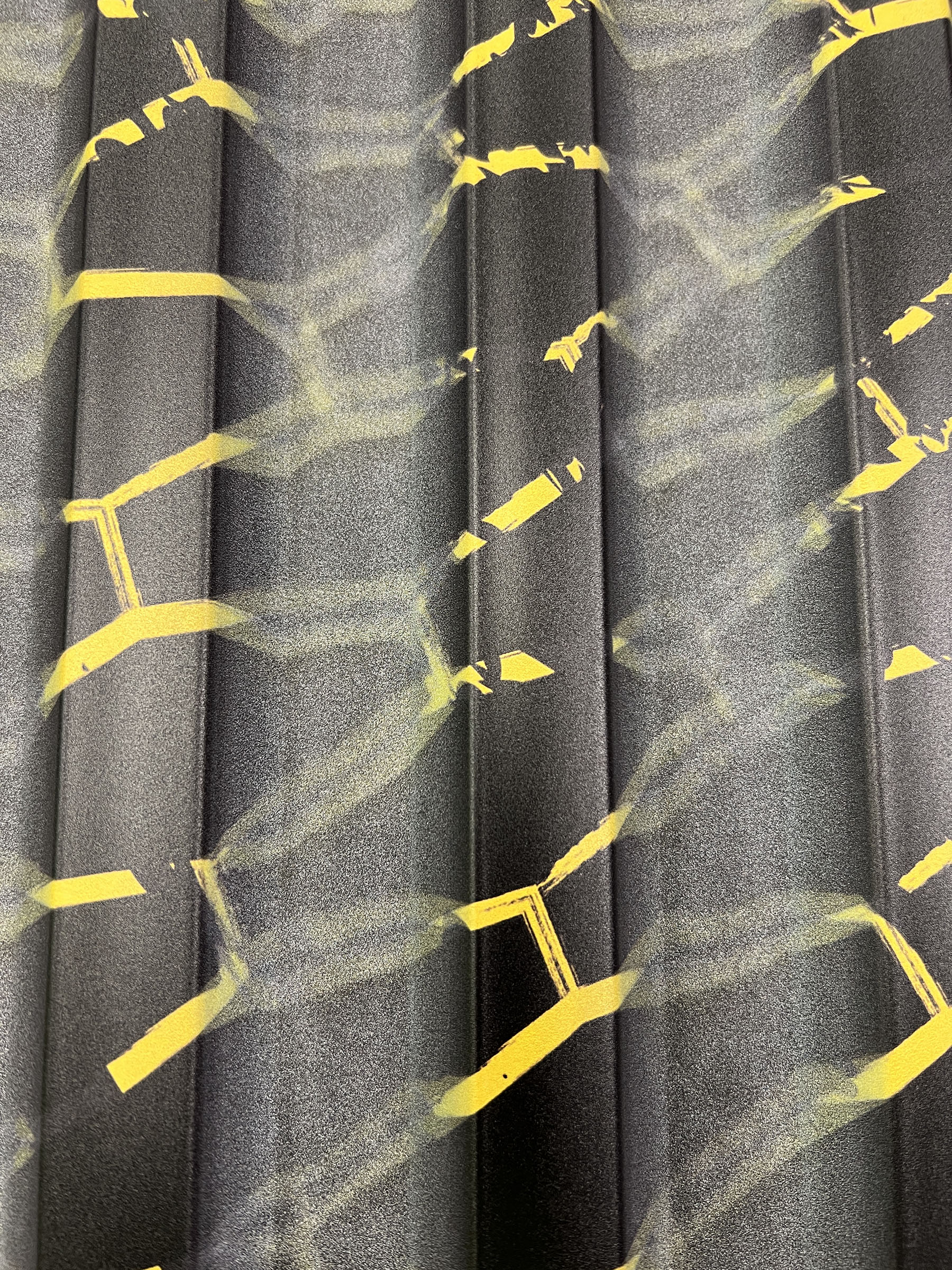

We are attempting to flatbed print onto some ribbed plastic panels. The recesses are about 5/8" deep. I knew the print would fuzz out, but I was hoping it wouldn't be this bad. Overall graphic size is about 8ft x 14ft, so hoping we don't have to go the vinyl route. Is this doable with a flatbed printer?

That is a “no can do”. Your ink droplets have further to travel, you have more area to cover, etc.
That is why flatbed printers print on FLAT or virtually flat materials.
