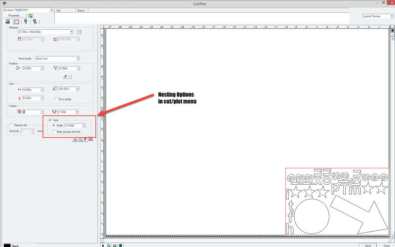

1) The cut/plot menu
attachment.php

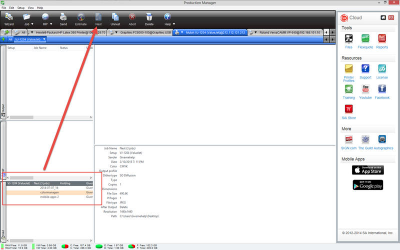

3) Nest in Production Manager
attachment.php
attachment.php
