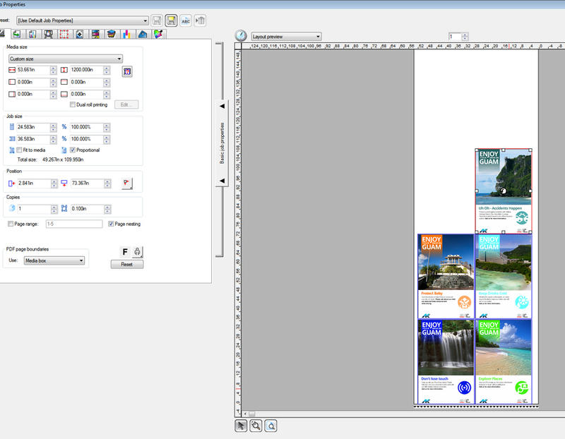

Hi,
just got a copy of Flexi cloud (freebie with a new printer).
Is there a way to rearrange the pages of a multi page pdf in the production manager so they can be ganged to fit the material?
Right now each page stacks on top of the next without a way to move them individually - as far as I can tell.
Could be a lot of user error on my part but so far I'm not much impressed with the jump from v8 to v12.
thanks in advance
wayne k
guam usa

Thanks,
they seem to stay locked to each other and I can't work with them individually.
Clicking the "Page Nesting" button on and off didn't have any effect until I changed the print orientation. Hitting page nest then got me almost there. I have 4 pages side by side but was unable to turn the 5th page horizontal so it would not waste a another full row of material in height. Work around was to load the PDF twice and set the page range to 4 on the first and 1 on the second then nest the 2 of them.
Funny part - once you nest the PDF with something else you can move each page around individually. Seems like it should be an option for a single multi page PDF too.
wayne k
guam usa

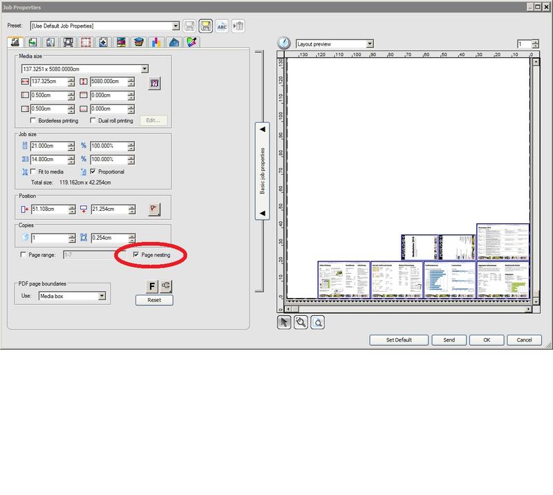

Try "Page Nesting" in the layout tab of Job Properties (see screendump). No need to crush the print job into pieces.
Thanks for the reply.
I did try to use the page nest option but could not figure out how to turn the last page horizontal while leaving the other 4 vertical.
The rotate option turns all the pages and not just the one.
Using the suggested "break apart" option it split the 5 pages - nested and arranged them exactly how I wanted without further input from me.
