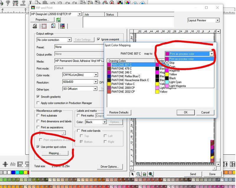

Is there a way to make this a default? If I print Pantone colors, I have to check the "use printer spot colors" then click on "mapping" and switch every one to print as process color. If I forget, it just prints a solid black, yellow, etc. And I keep forgetting :banghead:

un-check "use printer spot colors"
and it will process all of them.
We only use this feature to print black with only black ink.
