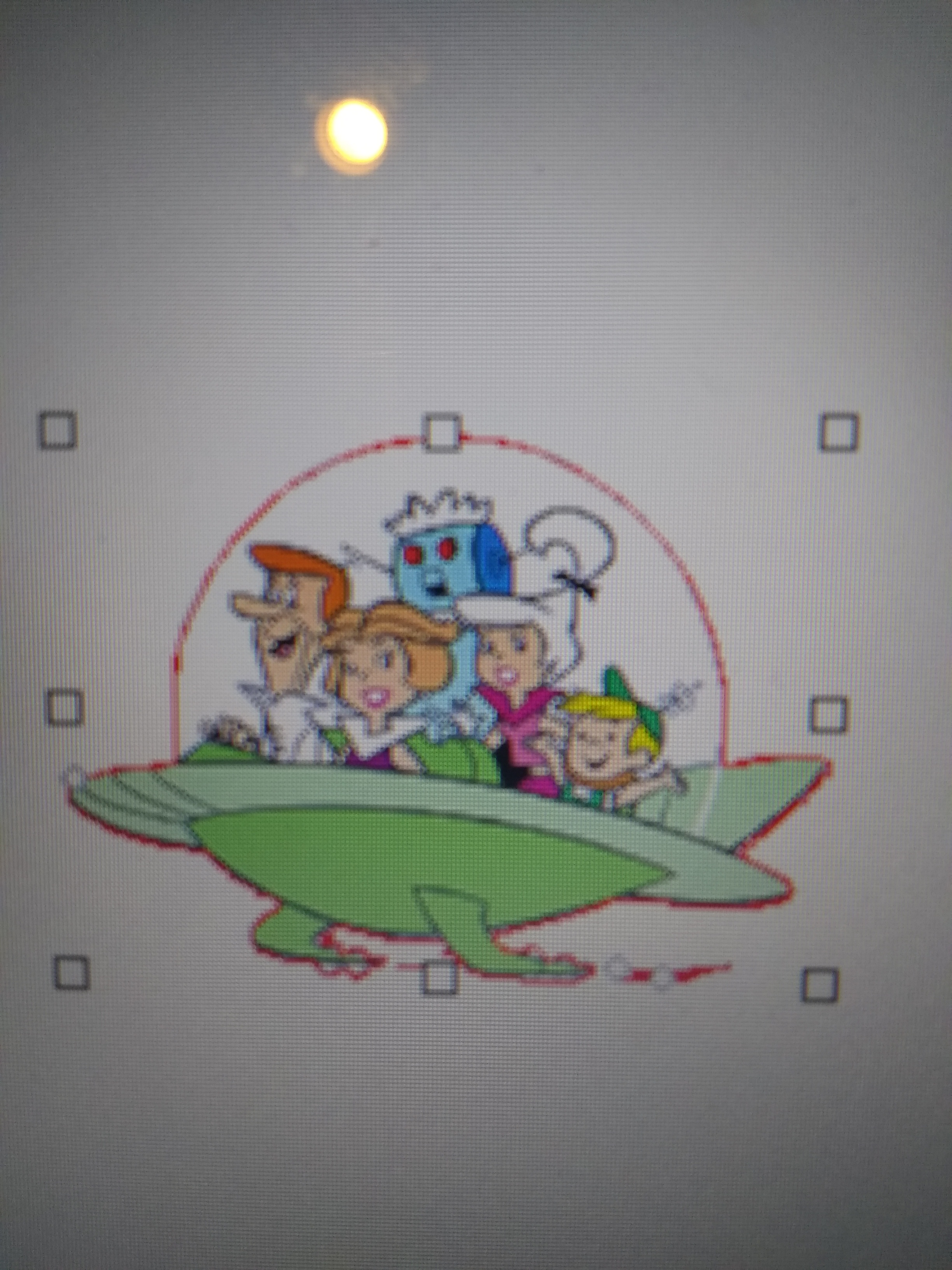

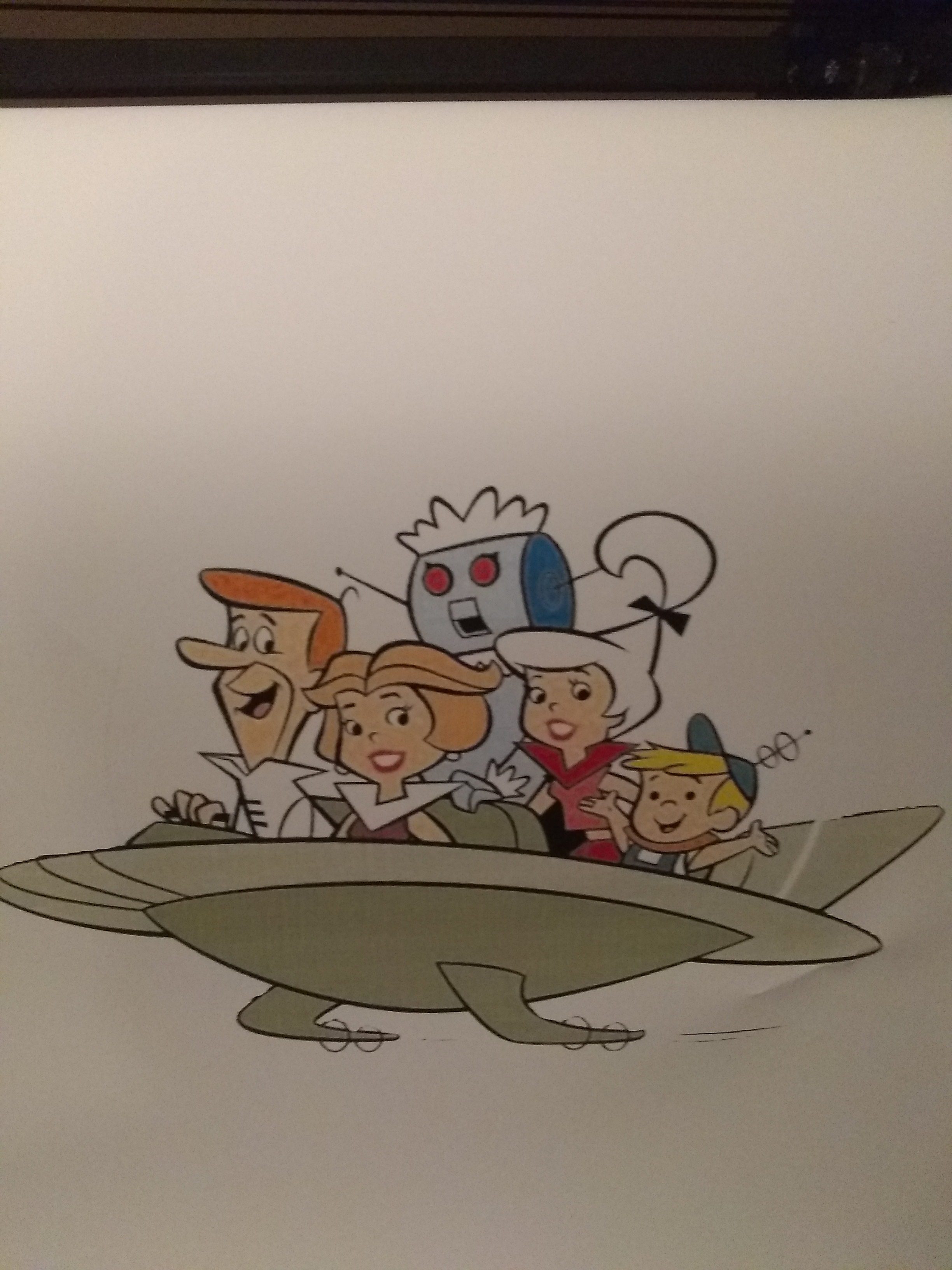

Can any one plz help with colors they are not full and slightly off I'm printing with flexi 19 and a Roland pc 600?

Regularly, if you do not print with spot color ribbons that match the needed colours (and define them in the file), you will not have „full“ colours. In addition, thermal transfer printers are printing with a very rough dither.
Check Chapter „Halftone (printing process) at Wikipedia.
FrankW
An ICC-Profile will not help with the dithering. It could help with the „slightly off colours“, but that kind of printers are hard to calibrate.
Could be that on older versions of Flexi profiles are available, but because of this machine isn‘t been sold anymore for more than 15 years, they aren‘t converted to the newest versions.
