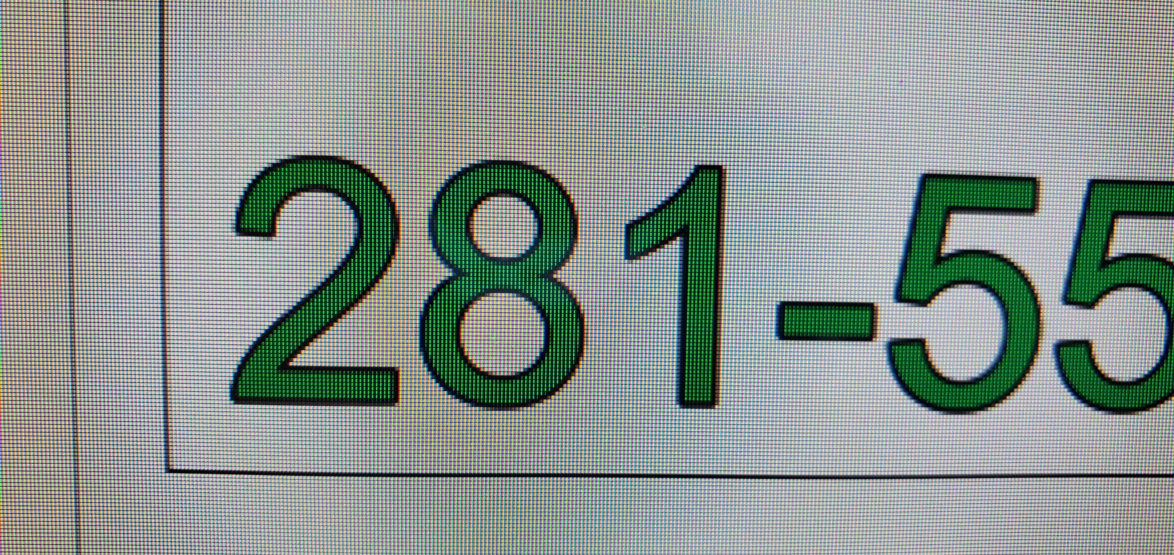

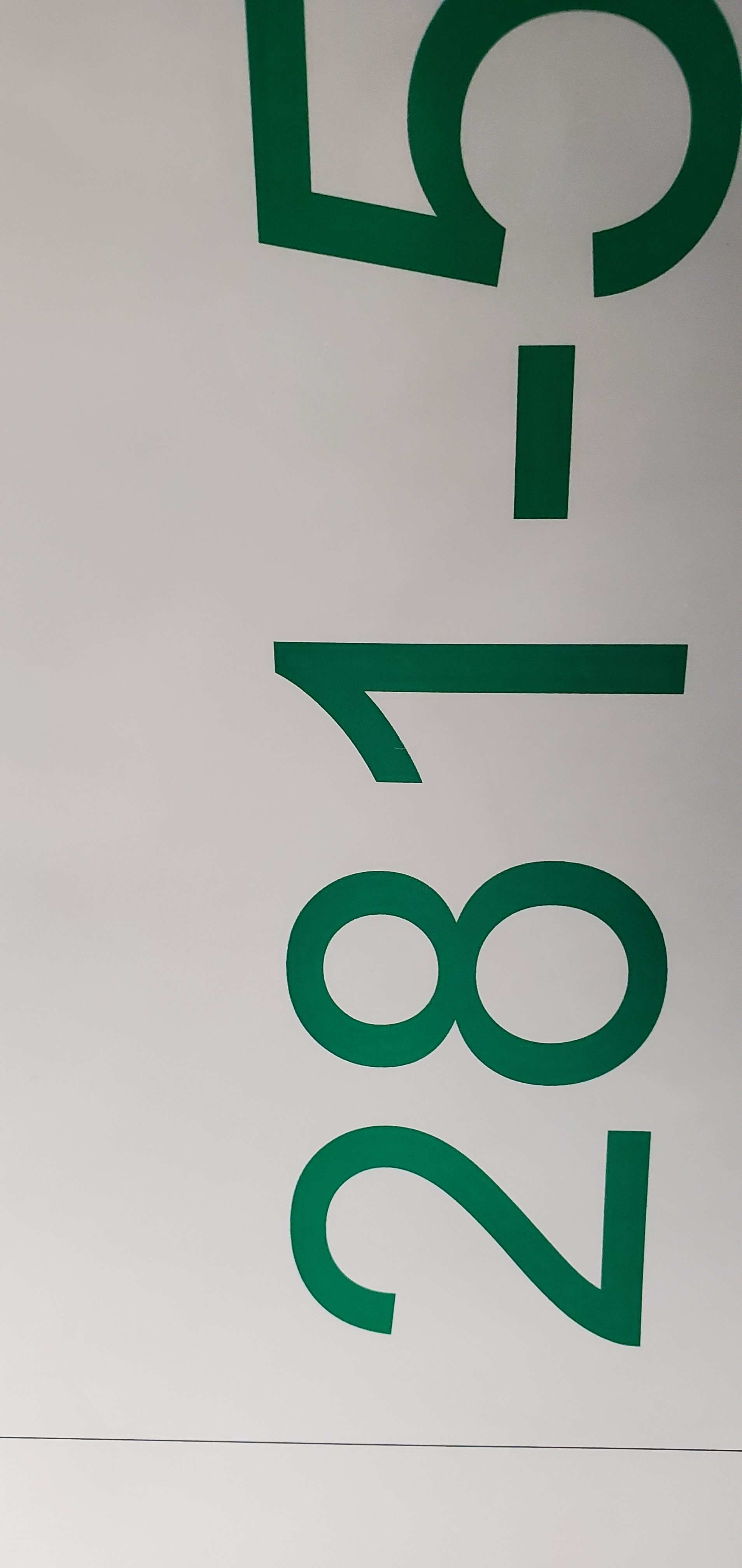

I have a question that has me stumped. I created artwork in corel. Green lettering and then I placed a black outline around the lettering. I exported as a PDF and then put it into flexi to print. I could see the outline in flexi, but when it printed, the outline was not printing. Any ideas on what happened? I exported it as a jpeg and it saw the outline.
Any help would be appreciated.

Convert your outline to object in Corel before exporting as PDF. Flexi may not be seeing the thickness of outline when imported or ripping.
ah ok! I knew it was something simple. I could not for the life of me figure out what I was missing.
Thank you!!!
