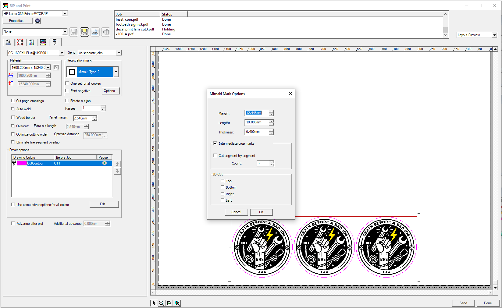

I'm using Flexi to print from an HP335 and cut on a Mimaki CG160FXII, I'll upload a screenshot of Flexi showing the cutting setup, using Crop marks Type 2.

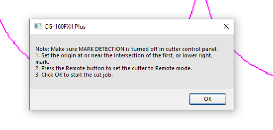

Print goes all good, then i'm taking the print to the cutter and I think here is where i'm doing something wrong.
I load the print in and position the blade on the marks a per manual, hit remote, and then go back to Production Manager (Flexi)
and hit Send, i've got a pop up showing the second pic attached, then I hit OK and nothing happens.
Reason i'm doing it this way is because i need the Intermediate crop marks, as i'm doing long print + cut files.
Any ideas how to get it going?
