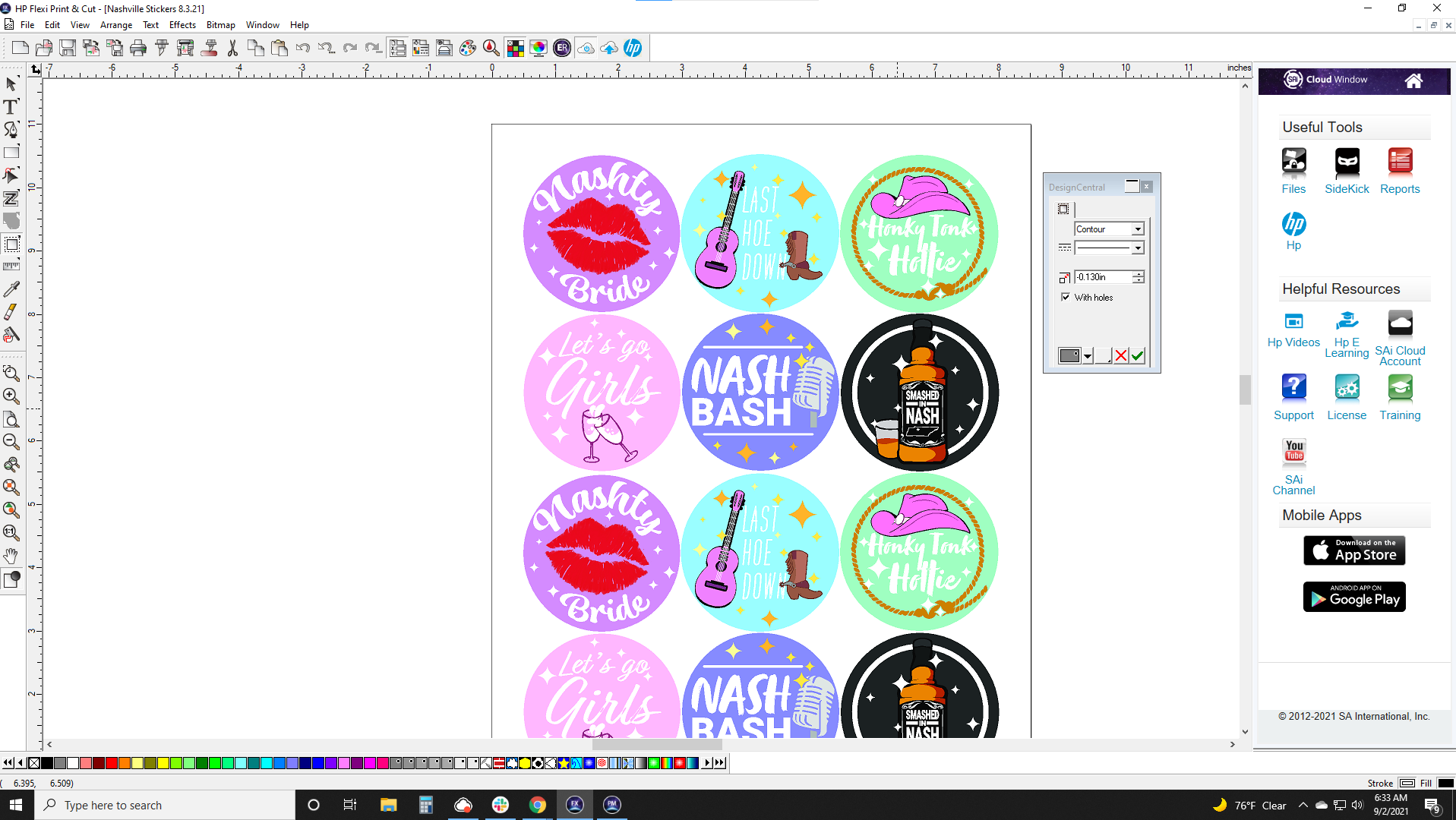

I've had this problem on two separate occasions now and I was hoping someone could help me. Whenever I try to set a contour cut they just seem to not populate, but if I were to use ellipse or rectangle those show up just not contour.

I've had this problem on two separate occasions now and I was hoping someone could help me. Whenever I try to set a contour cut they just seem to not populate, but if I were to use ellipse or rectangle those show up just not contour. View attachment 155223
This is likely a user setting.
Did you print these in the previous version of FS?
If so what is different in the settings? The previous version setting should migrate without issue.
If the 12 labels are to be individually cut I would think that they are ganged up too tight.
Ungroup the 12 labels, and open up the ganging a bit an select each individual label and apply a contour cut to each individual label. and uncheck "With Holes"
I arrive at this because I do not see the grey contour line around each label.
With the 12 contours applied, you can now select all twelve and Go to RIP
when you select the Contour cut function you should only see the 12 circles.

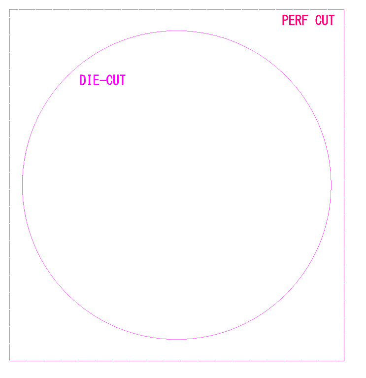

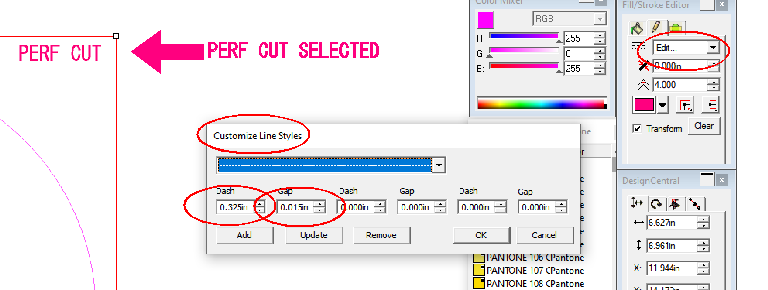

In Flexi:
For contouring and perf cutting, we convert both lines to Contour Cuts, then edit the perf cut line in the fill/stroke editor to fuchsia and customize the dashes and gaps. When you RIP and print, just make sure to tell Flexi to pause between colors so that you can change the knife setup - this varies widely on your cutter setup.

In Flexi:
