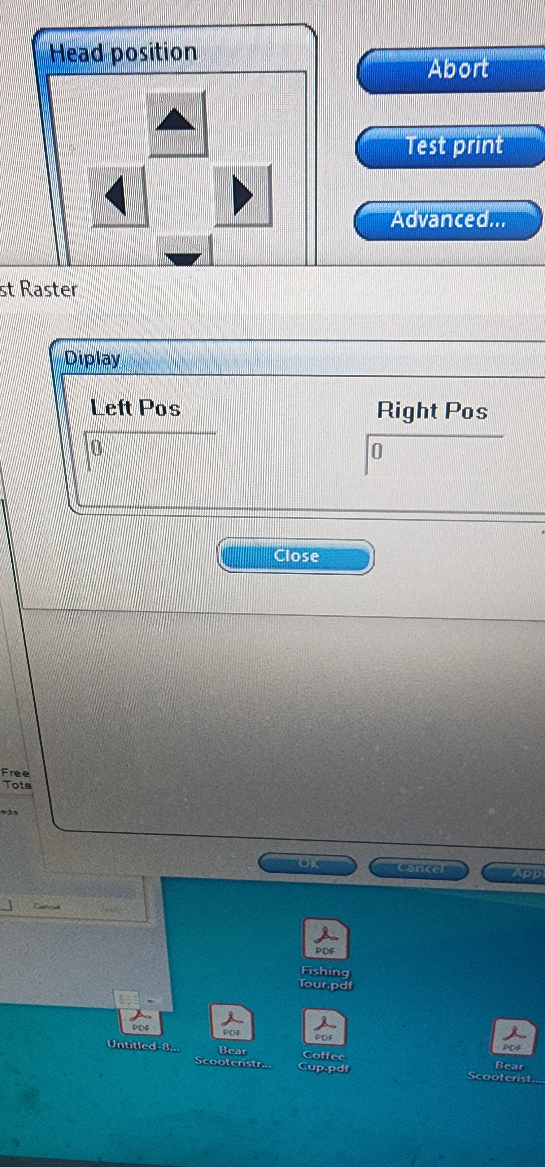

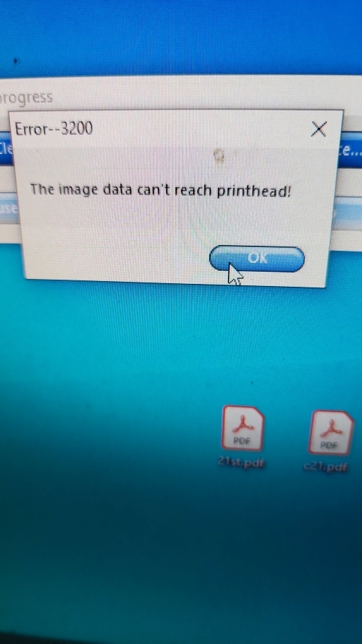

Hi does anyone now what this problem is on the flora 2512 uv printer
please see the pictures attached
any help would be great thanks

Looks like an internal data transmission problem. Try to rip a picture using only one pure colour (one of CMYK), maybe you'll find, which channel has a problem.
tonyrey35
Thanks for that but it will not do a print head test just get the data transmission problem but will have try

Maybe if you print just with a single channel (i.e. C), there will be no problem as other channels won't receive any data?
tonyrey35

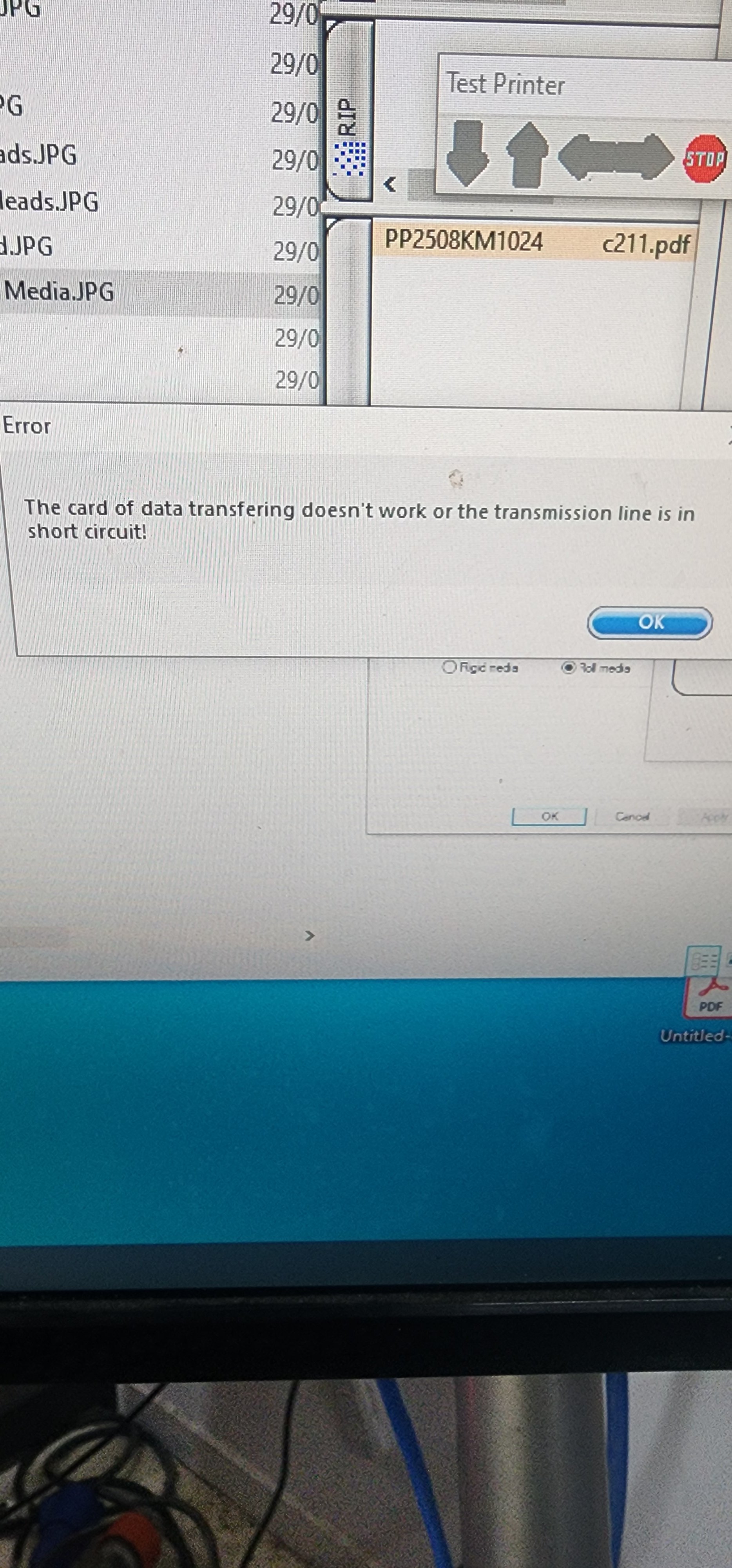

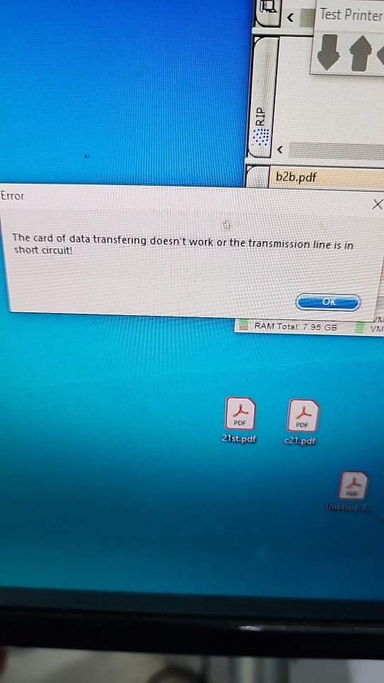

Hi tried that but same problem. It's also not reading the raster test. And no print head test

Switch off the printer and try to reconnect all communication cables inside, maybe there's a lack of contact. If it won't help, I guess you need a technician to diagnose/fix the problem.
tonyrey35
thanks will have a go , we have no technicians around where i live thats why i am looking for help with the problem thanks again for your input .
