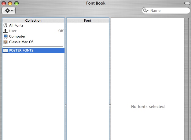

You'll notice in the attachment i posted that each of those font locations listed above are icons in fontbook.
I keep all the fonts that I want loaded all the time in the SYSTEM.
Make a new folder on your drive for your project "POSTER FONTS" or whatever. when you drag that folder to the far left window of font book it creates a set called "POSTER FONTS" and turns them on automatically.
When you want to turn the set "POSTER FONTS" off - right click and go to disable.
You will see any set that you add - the fonts will show up under USER instead of SYSTEM.
