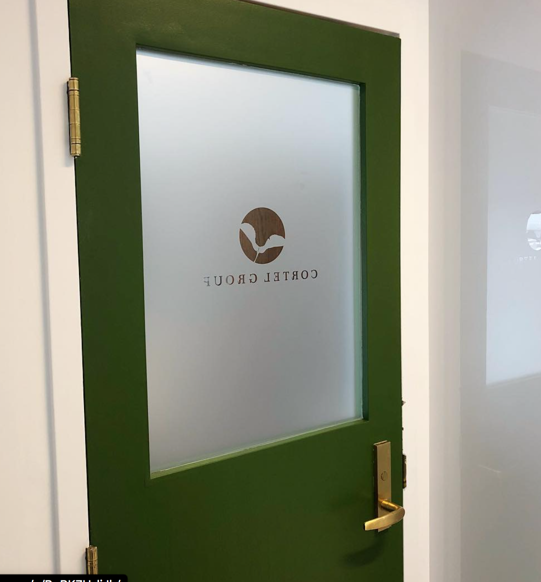

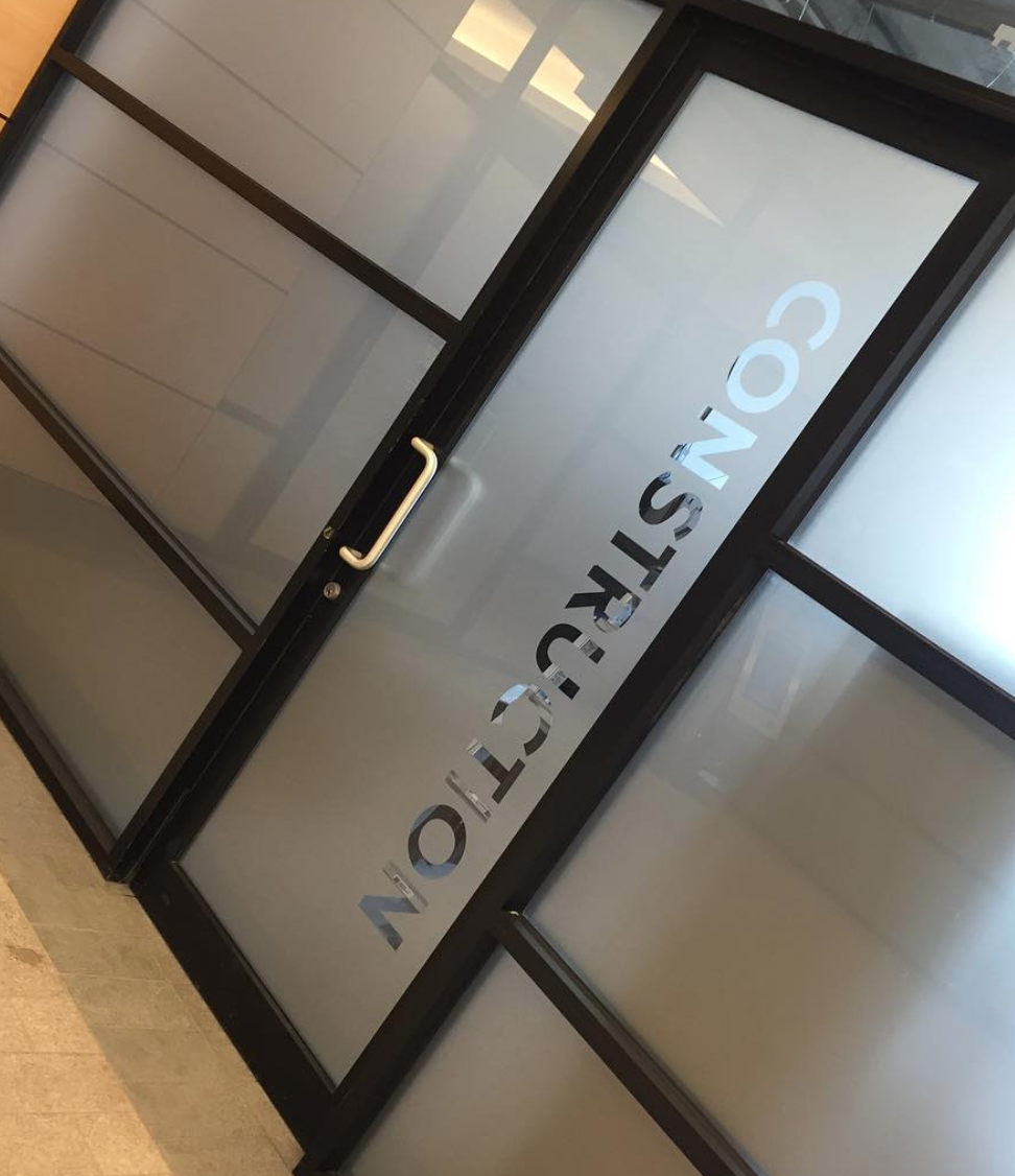

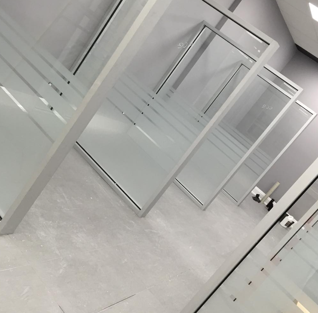

I commonly use:
3M 7725 dusted crystal with 3M SCPS2 prespacing tape
OR
Mactac 9700 Frosted with 3M SCPS prespacing tape
Removal of application tape always seems to be a small battle. I often try:
- Wetting the application tape before removal
- letting it sit for a while before removal of the application tape
- using rapic tac application fluid instead of soap/water combo
Wondering what combo everyone else feels most comfortable with. Words of wisdom always welcome!:)

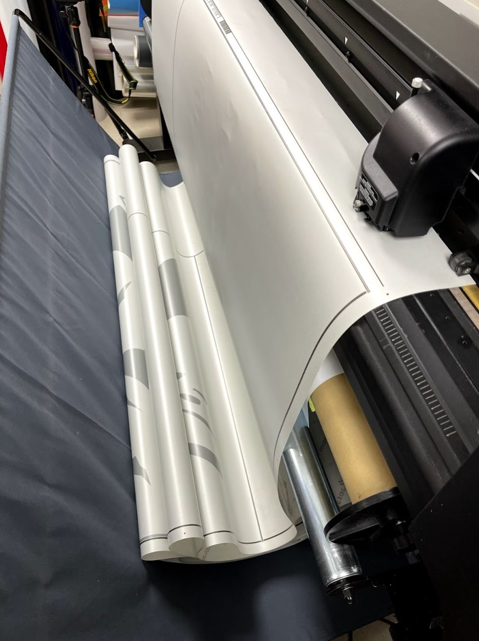

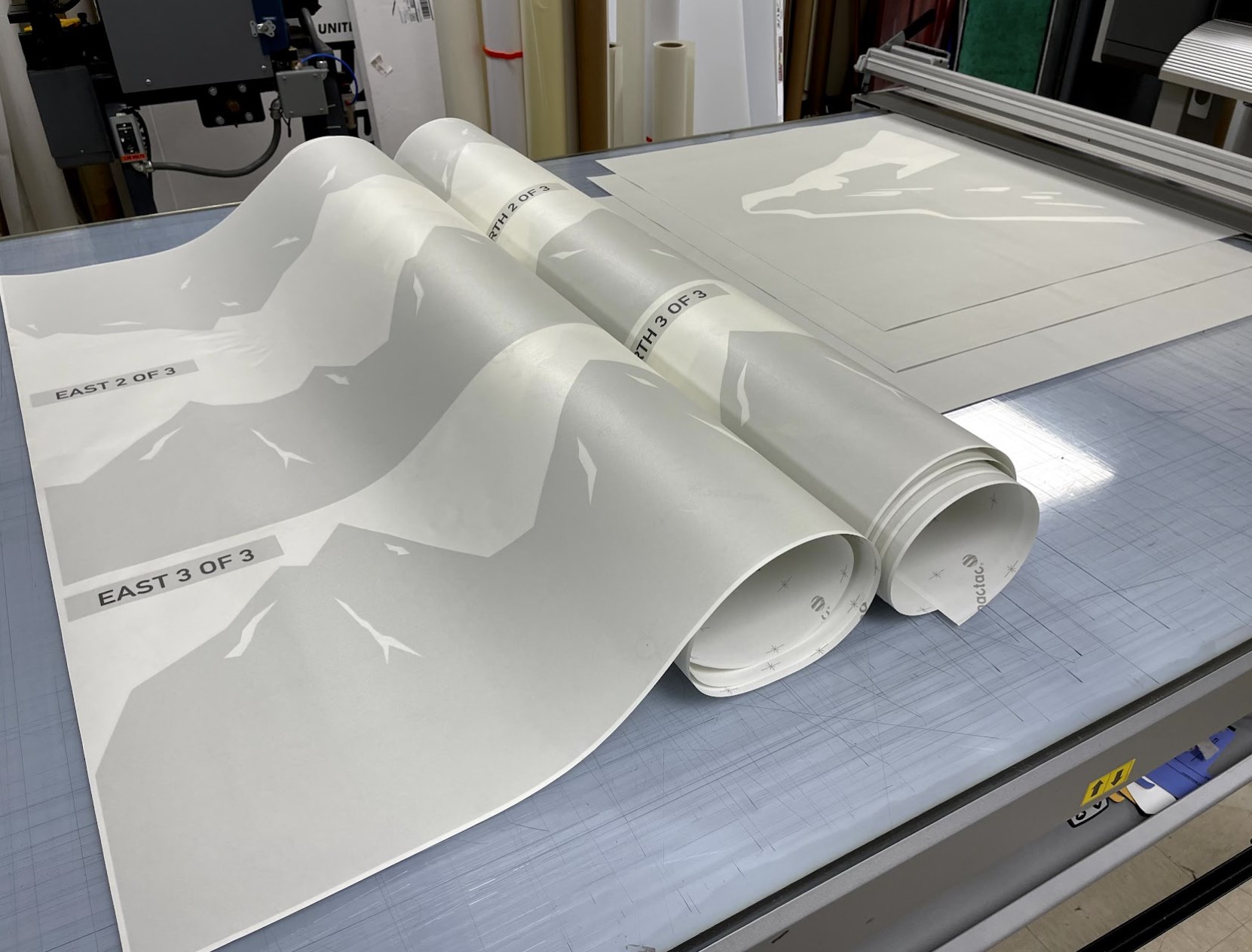

7725 and the MacTac are both pretty good. As far as production goes -- The best trick I found is to digitally print the areas I'm going to weed. I also print the Trim-o-Matic marks for my Fotoba, and I use TransferRite AirMask 510U for the application tape (which is plenty aggressive, and it allows the Fotoba to read the registration marks. That's about as easy as it gets (I think!)
