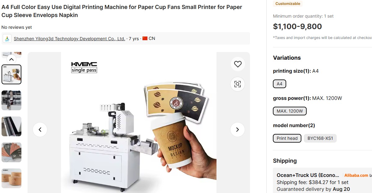

victor bogdanov
I want to print napkins, bags, coffee cup sleeves and pizza boxes so not a high dpi I'm thinking of buying a off the shelf printer use the guts and electronics to run the head just locate the head to mount over a flat conveyor belt. Would probably need a vacuum belt conveyor I'm guessing. Ideas.
I've seen some Chinese printer ads that do just this, maybe will give you some ideas for which head to use
https://www.alibaba.com/product-det...offerlist.normal_offer.d_title.2f4013a0fFgTUb
Smoke_Jaguar
Played with the FocusInc ones, great for paper labels. About $5500 for the printer, and if you use their ink, about $25/liter. The conveyor version is around $8k.
