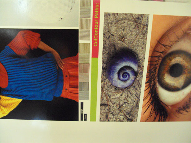

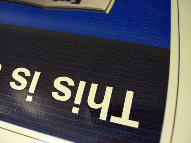

I am having an issue with FutureRip. I am printing to a Prismjet Extra(Mutoh falcon outdoor jr. 38"). I initially had some good quality printing on Vinyl & then printed a 3'x6' banner, came out great. The next day after printing the banner I start printing on vinyl(I did lower the head back down) & terrible quality. I have uninstalled, reinstalled, reloaded the profile & on & on...I did a quality test print from Mutoh website that bypasses the FutureRip. It was great. I would appreciate any help getting this back to where it was.
I have attached the test file from Mutoh site(prints fine) & a test file included in the FutureRIP software.

First thing today was run cleaning cycle. Then print from FutureRIP(terrible quality), then print using the Mutoh Utility(good quality) I think it is something with the RIP Settings, or Profile somehow.

Have you tried setting it up using a parallel cable to rule out the SEH box? However, as I type this I'm wondering how you sent the Mutoh test job? Through the network SEH box? Is so, that should rule out the box. I've always used Production Manager that came with Flexi for my rip. Works great with my Falcon. I'm assuming you have use this material before without a problem? Looks like too much ink (profile settings) or the heaters might be set wrong. As for raising and lowering the head. I've always for the last 4 or so years kept mine in the up position. Less chance of a head strike.

36C for both heaters. I know Sign Warehouse suggested 50C for both but I think that is way too hot. I'm not familiar with FutureRip. Does it have ink override/limits you can adjust? Are you using Mutoh brand ink? I went with 11/10 for a while and had to further adjust my ink limits.

Kind of hard to see in the image. Is it just the black with the issues? How long have you had the printer? Any help from the person you bought it from?
thmooch
I have been out sourcing to a MM here for a while with great results. I picked up this printer for what I thought was a fair price. All colors come out "blotchy" when printing through the RIP Software. Maybe I will get in there & start changing settings, can't get any worse right?
