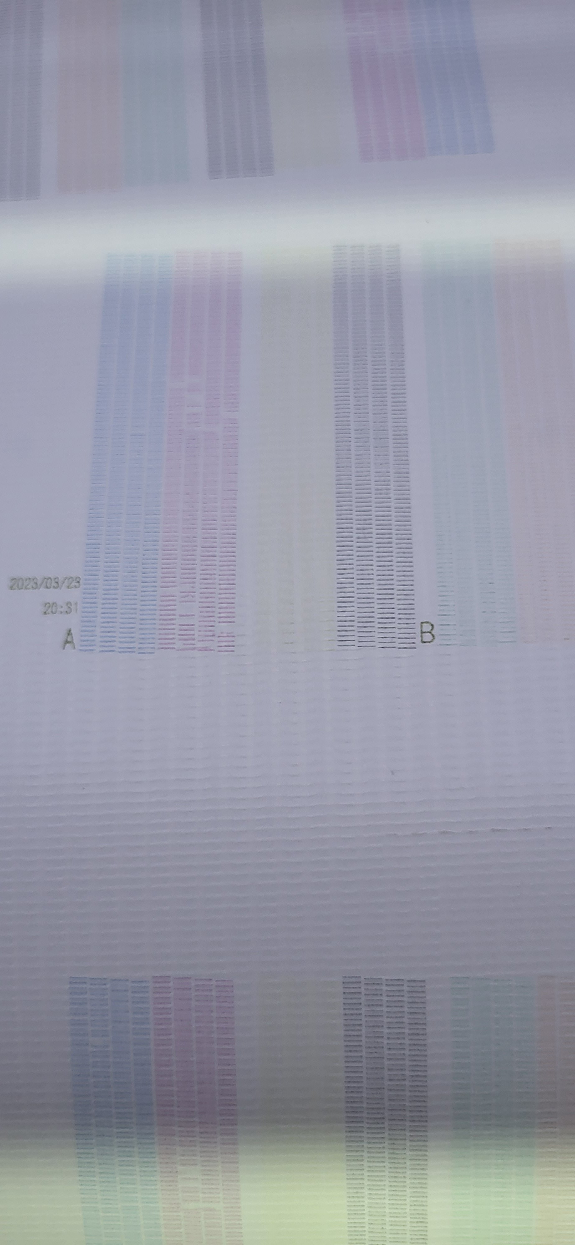

Hi,
I have a Roland vg2, it's been running fine until this last week I have gaps in Magenta in A. I have cleaned it manually, heavy clean, emptied damper (advised by roland) and still it has gaps. All other colours are fine and magenta is fine in B 20230323_132510.jpg . Does anyone have any other ideas on how to fox this before I have to spend hundreds getting roland out? It's quite cold in the unit, not ideal I know (waiting for heating to be fitted).

hundreds of possible reasons until you clear up the whole story about the case

As long as it's not from a head strike, soaking the head might bring it back. That's where I would start.
