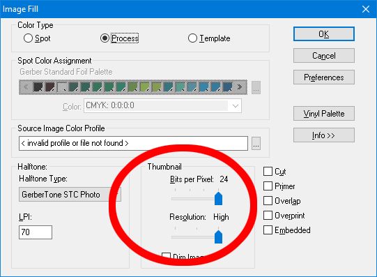

With the image selected, Go to the Image Fill Dialog by entering Shift +1 from the keyboard. Once there, set the Thumbnail Resolution to 24 Bits per Pixel and High Resolution.

Those were both set correctly, it's not just blury images it's anything I design. It does it to text or any shape
