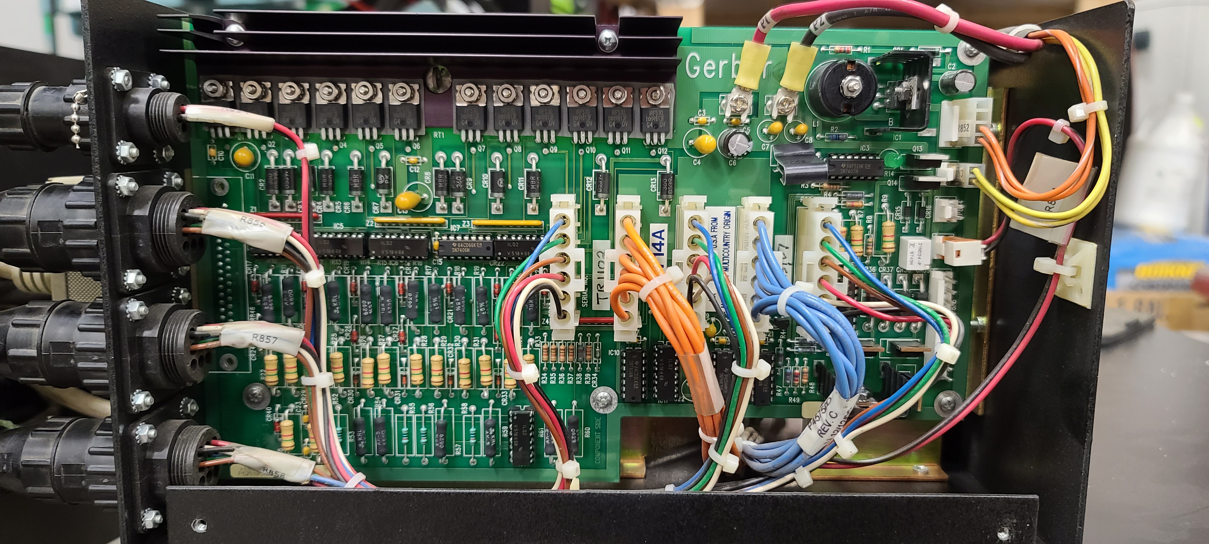

Removed X,Y,Z Axis screws and thoroughly cleaned and re-greased with White lithium.
Blew out the Black box and checked all connections
Checked all Stepper motor connections and added a small amount of Dielectric grease.
Cleaned the rails; everything moves like butter and doesn't feel like I am hanging up on anything.
I am going to do some more taring down; but I wanted to check with this knowledgeable group before I waste any more time.

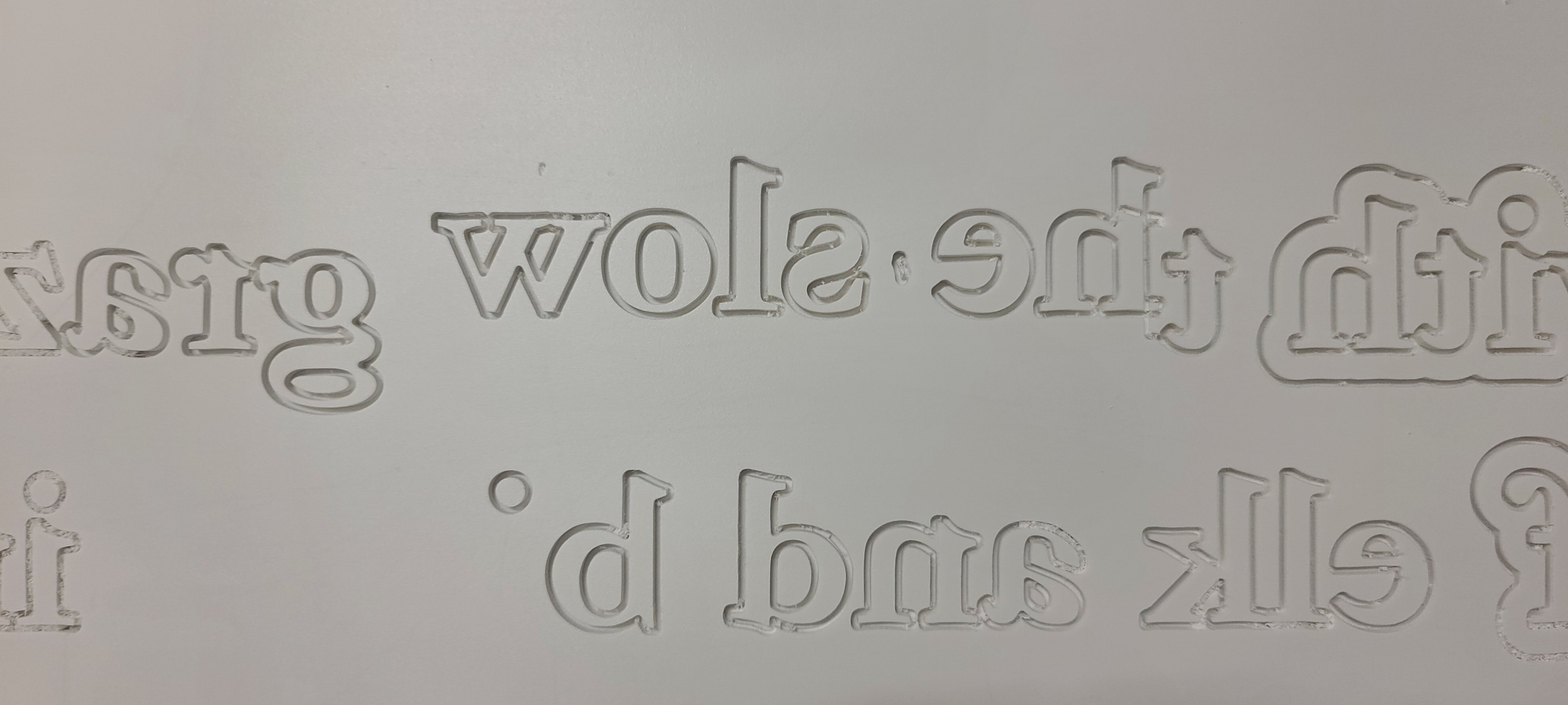

Description of the job is to make cement stamps, where I have to do a rather large cleanout with reversed lettering out of white PVC.
Pictures attached of my hiccup; they happen randomly and in different spots with any type of file sent. Sometimes they will run flawlessly for a while, then another hiccup and I lose the job.
