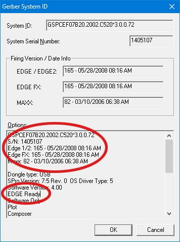

You can probably find out what you actually have if you launch System Identification String on the GSPTray menu.

The CS version is only for design and vinyl cutting. As such, you plotter is supported and your Edge is not. The CP version is for both cutting and printing and will allow the installation of an Edge. As I said in my last post, you should be able to see what features your dongle supports by clicking in the System Identification String in the GSPTray menu.
I have attached what mine looks like.
If you have an Edge Ready dongle then you should go to the seller and demand the version 2.0 CDs. If it isn't Edge Ready, then one can only wonder how the old computer was driving an Edge. Be aware that version 1.5.6 is about 15 years old and very out of date. It will be difficult for you to get support from anyone.
