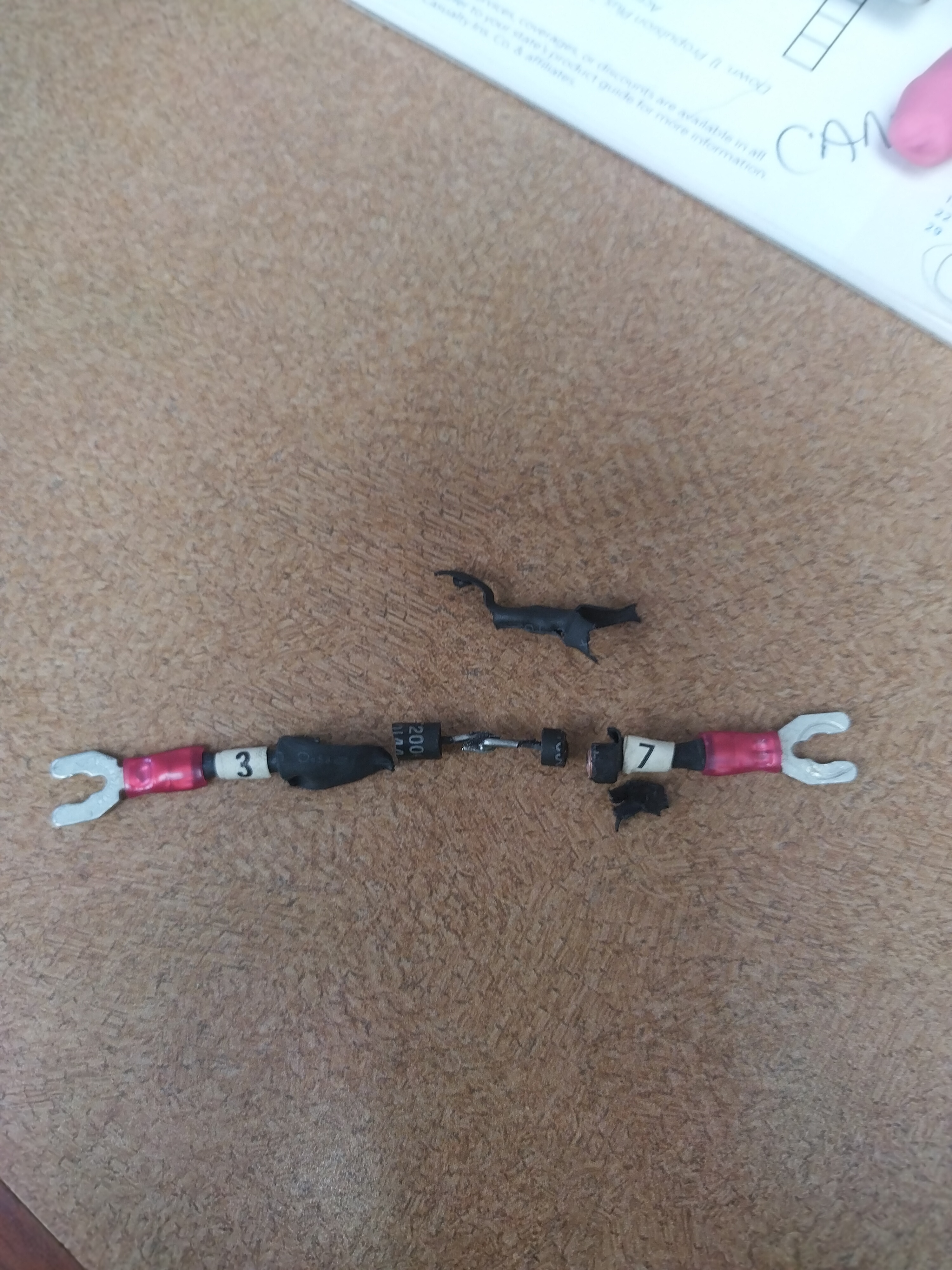

Anyone out there have one of these? We had a part pop. It's the trans orbital diodes from line 3 to line 7 on the bus bar. Looks like a voltage regulator to me, but the diodes blew up so bad I can't read them. We have called Gerber, but they are out of the cnc game and didn't seem to want to help much. We keep getting the run around. We have a job on the table and they are piling up behind it. Started looking at new routers but they are about 50 to 80k and this part is around $3 worth is diodes. Of someone could open the shrink wrap on their link I could get a picture of the diodes and make a new one.
Thank you.

So, you may get the answer here, lots of knowledgeable folks still pushing sabres to their limits, fdarling on here has developed a drop in replacement board for these machines, aside from that, he has intimate knowledge of the machine, and could probably tell you what diodes in a second. Here's a link to his post about the motherboard replacement.

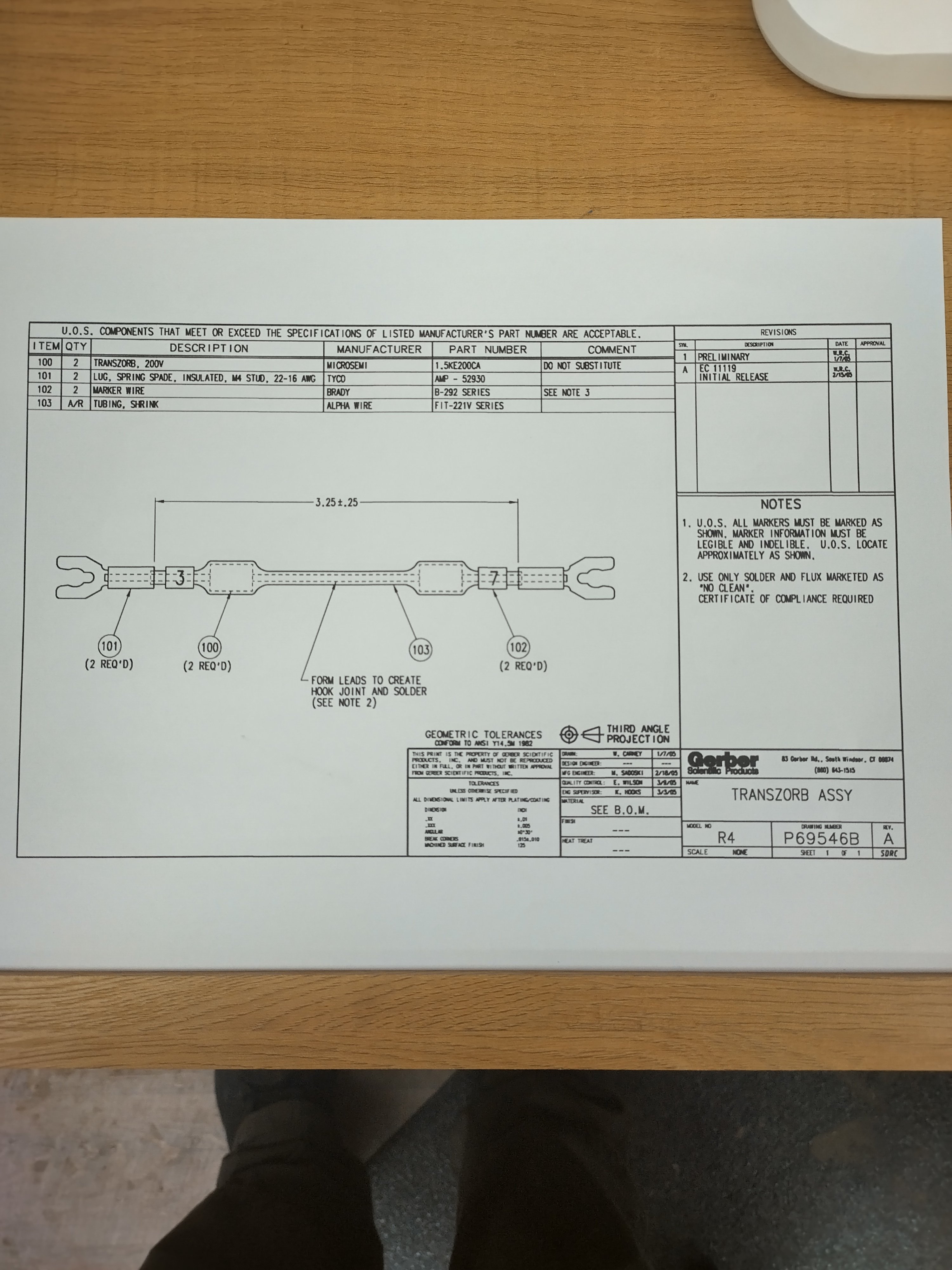

Thank you! Finally got someone at Gerber. They sent the schematic and could make piece at $40 each, minimum 19. Lol. Mouser had the parts for $1.21 each. We will make our own. Here is the pic of the schematic of someone needs to make one.

That's the thing with most products these days.. Easy enough to repair IF you know what you need to replace.
