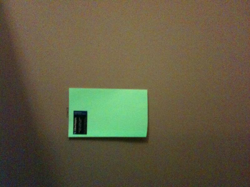

Seeing as we have now sold all of our in-stock Roland equipment (good month), I will be able to snap a pic of the unprinted product.
CS-SignSupply
Took the sample to our hallway and took two photos with my iphone (not the best quality, sorry). One pic is partial light, door to hallway open. The second is image in pitch dark.
Let us know how we can help.
