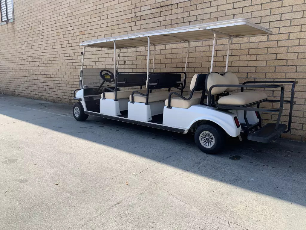

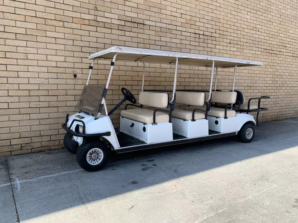

Hey everyone!
I could use some advice; I need to price a printed wrap for this vehicle, but I’ve never wrapped one before, so I’m a bit unsure about the pricing. It doesn’t look like it’ll take a ton of material, but the labor is what concerns me. I want to give my client a fair price while making sure I account for the time it’ll take.
Since I’m not the fastest at wrapping, I’d love any tips on how long this type of job usually takes and any tricks that might help with the install.
Appreciate any help!

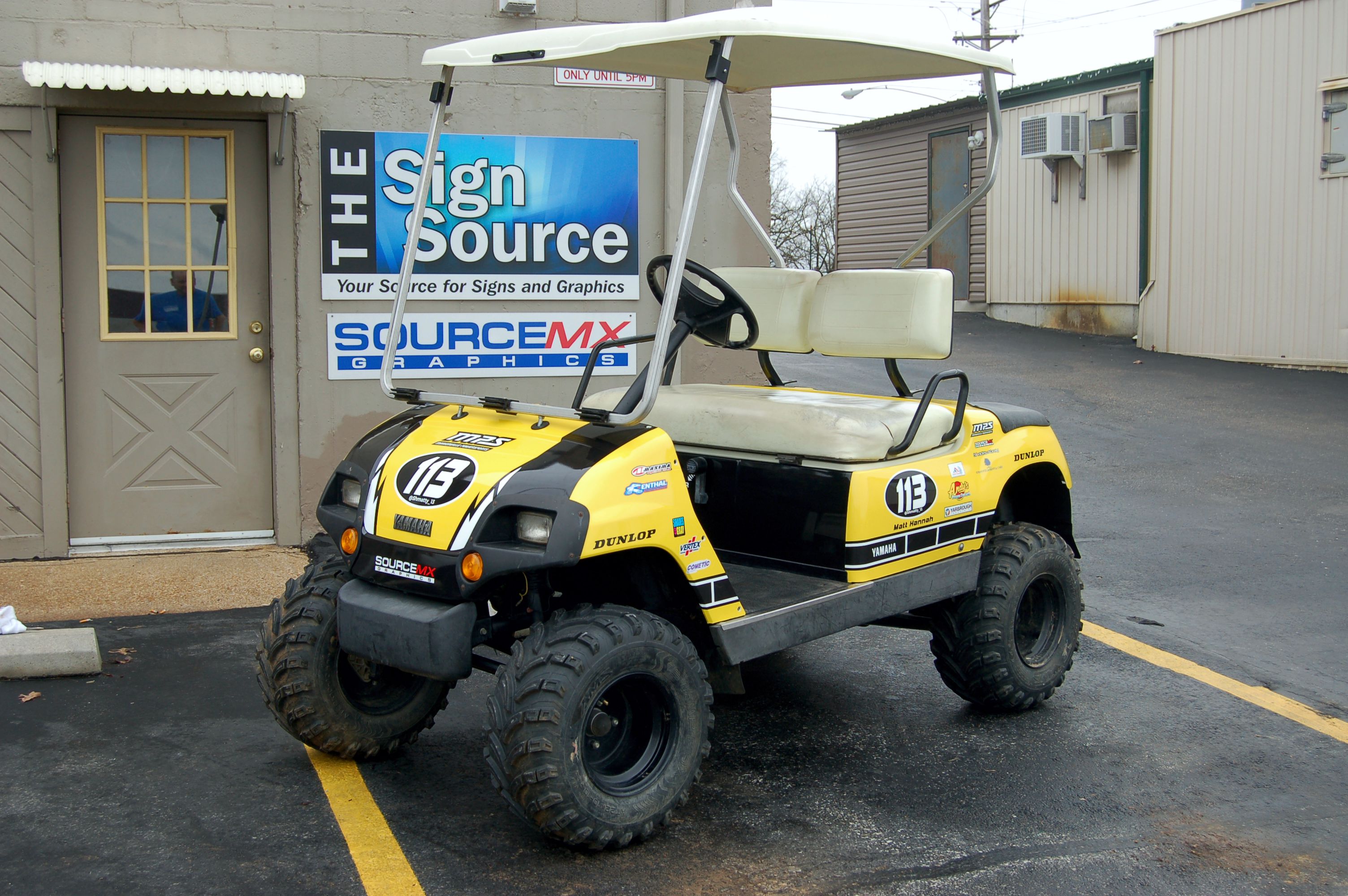

If you really wrap it, it takes forever compared to the square footage of vinyl. You'll want to have the bodywork off the cart so you can work on your table. The last one we did was just a two seater. It was 60 sq ft of vinyl and 7 hours of installation.

That looks nice man!
Appreciate the input. I've done just a few vehicles, mostly lettering and partial wraps and a few full wraps in truck and vans, so this is still a new game to me.

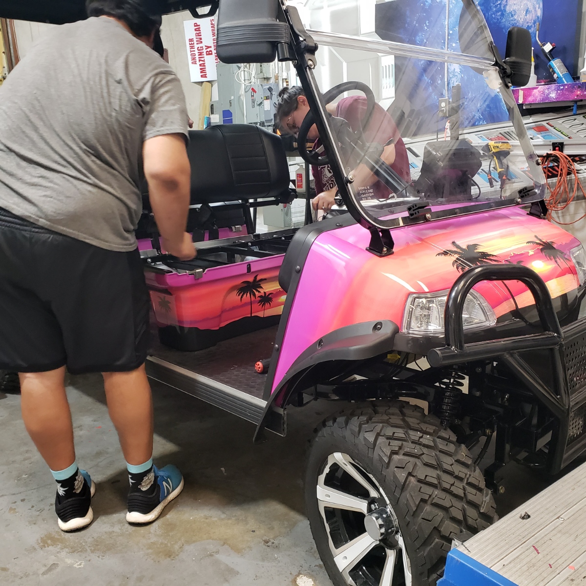

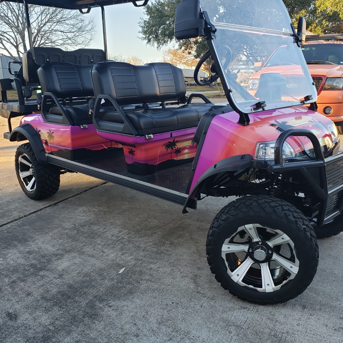

we just did one with one less seat. this one took about 4 days. but we took everything apart on it.

You might consider a color change with overlays. Unless the printed wrap is a solid or pattern that lies easy, it is hard to get everyhting straight unless your a really good wrapper. Between the time and the reprints its not worth it. We try to get $925 - $1500 for a regular EZGO 2 seater. depending on the client. That one there probably twice that price.
