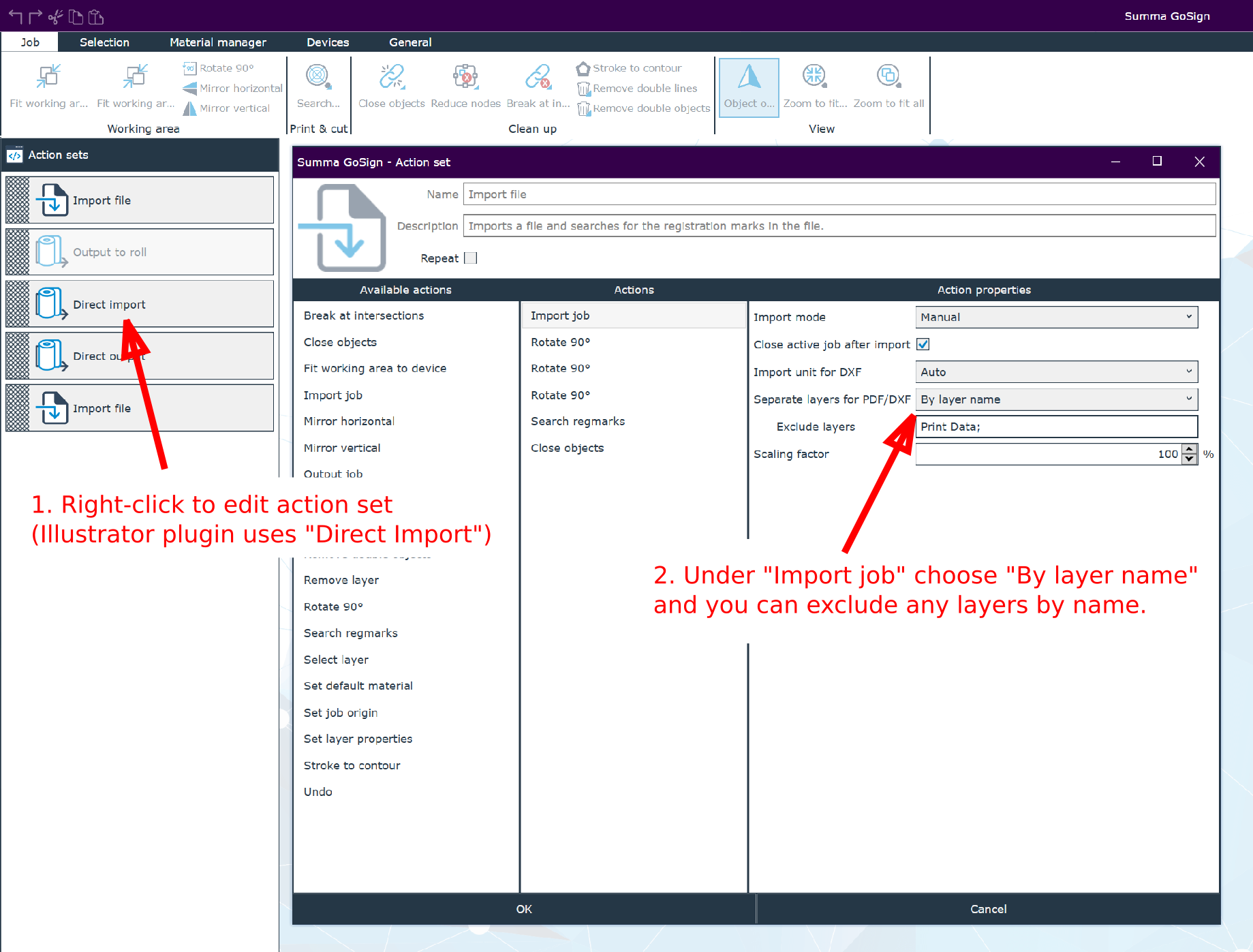

I use Adobe cc and Signlab 9.1 as design software and, from Illustrator, start using the Gosign and Winplot plugin to comminucate with the Summa. I run Windows 10.
So from Illustrator send the printfile to Versaworks, and the cut file to Gosign.
My problem, when sending a cut file from Illustrator to Gosign or Winplot it also sends all the layers that are not vissable and dont need to be cut. I actually have to delete all the layers wich dont need to be cut. Then while sending to Gosign, Illustrator somtimes undo's the last steps in the layout. So it throws back the deleted layers by itselfe. It also somtimes automaticly, while sending it to Gosign, saves the layout with only the cut file in it. When i'm not aware of that, and close the file my complete design is gone!! So there are some majure problems with Gosign and Winplot on my system.
