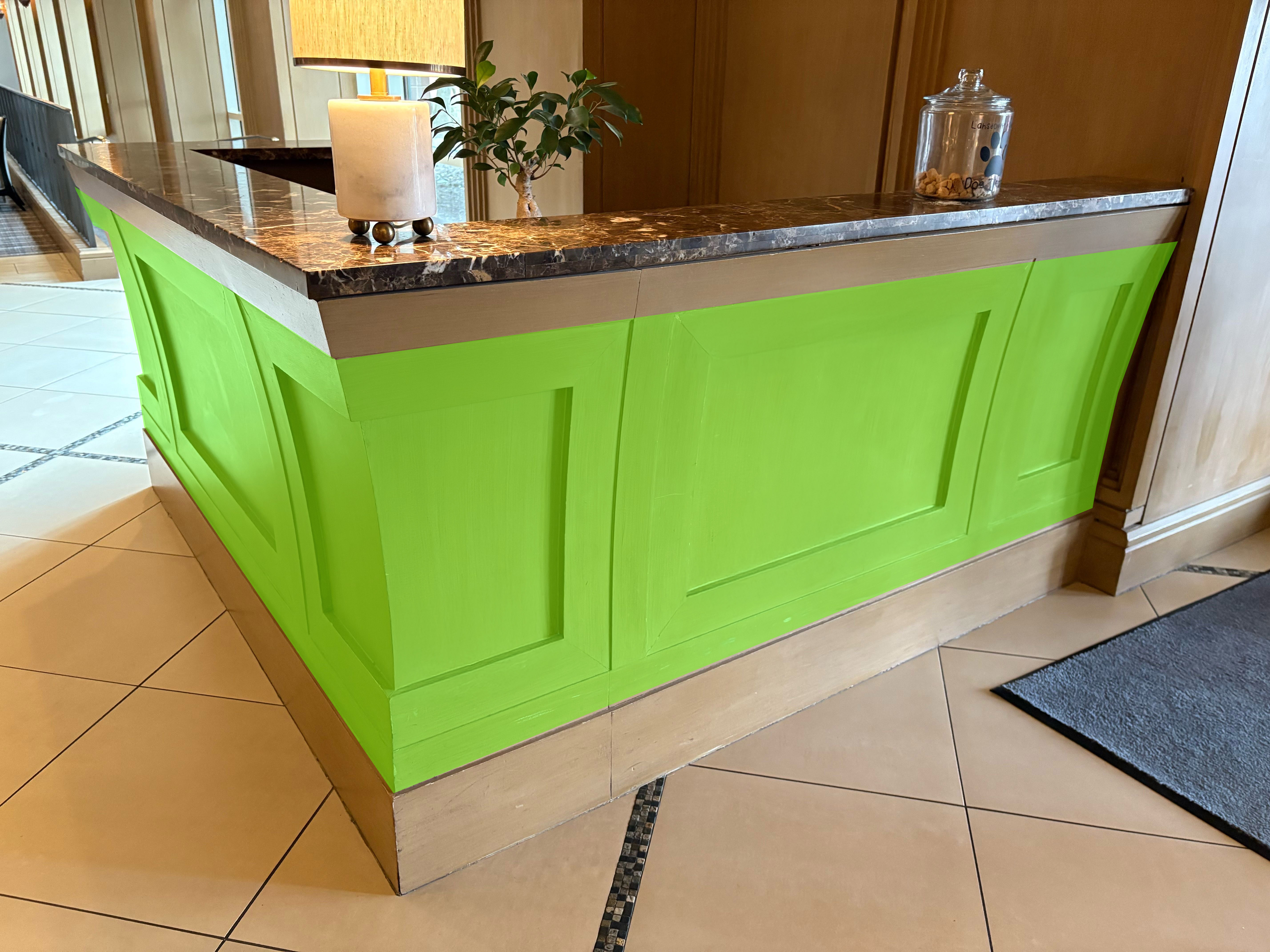

Have a large tradeshow coming up and client wants more impact for the help desk. Is there a way to use rigid panels to attach to the existing desk front and sides that mimics the curve and will look clean at the seams?

i would probably print then mount to semi rigid substrate like styrene or petG and then double side tape it to the raise portions allowing it to take the curve. On the corner both panels will have to have a bit of a round hand cut out to match.

I've been able to "roll" 4mm ACM using a larger diameter sch 40 pvc pipe, but haven't tried it that wide. Like crashaffinity suggested, styrene or petG should work.
