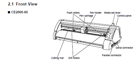

What you're referring to as the head assembly is the same thing that Graphtec refers to as the pen carriage in the attached graphic, correct? If so, it has quite a bit of play as far as moving it up and down and rocking it back and forth but I can't find any screws that seem to make any difference in that regard.
As far as posting pictures goes, I can try to take some but as it's very small cuts on white vinyl, it's extremely difficult to see the lines unless you hold it in the light just right.

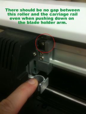

First thing to check... Power off and unplug. Take the blade holder out. Push down on the blade holder arm on the cuthead assembly.
If your machine is in good shape, you should reach a solid stopping point when pushing down and the carriage head guide wheels should not come off the aluminum carriage rail when you try to push the arm further down.

There is a definite gap between the guide wheel and the carriage rail. Less so when the arm is down than when it's up, but definitely a gap in either case.

i have the same problem on my graphtec i just bought used! i did what you said and has a slight gap, i tried to tighten all the screws i saw but nothing was loose lol:banghead:
CS-SignSupply
Sometimes, you need to remove the screws holding the spanning bar at the top of th cut head assembly, slightly bend the bar and replace... bending the bar gives it more tension and should keep the wheels tight against the guide rail.
